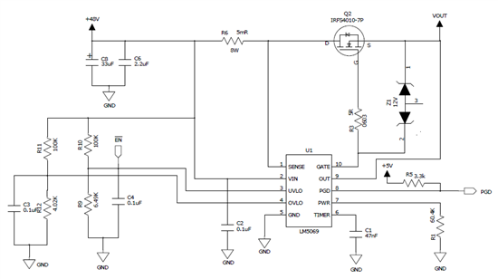

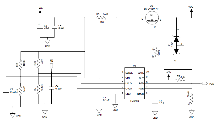

LM5069-1 (latch off type) drives a gate capacitance of ~10000pF in my application. When I tried to put LM5069-1in current limit mode, it tries to drive the FET periodically besides latching off FET. Input voltage is normal within this period.
I checked the UVLO pin, which I also use for enabling is ok (above 2.5V).
Also I checked OVLO pin which drops 560mV levels and returns to its normal level.

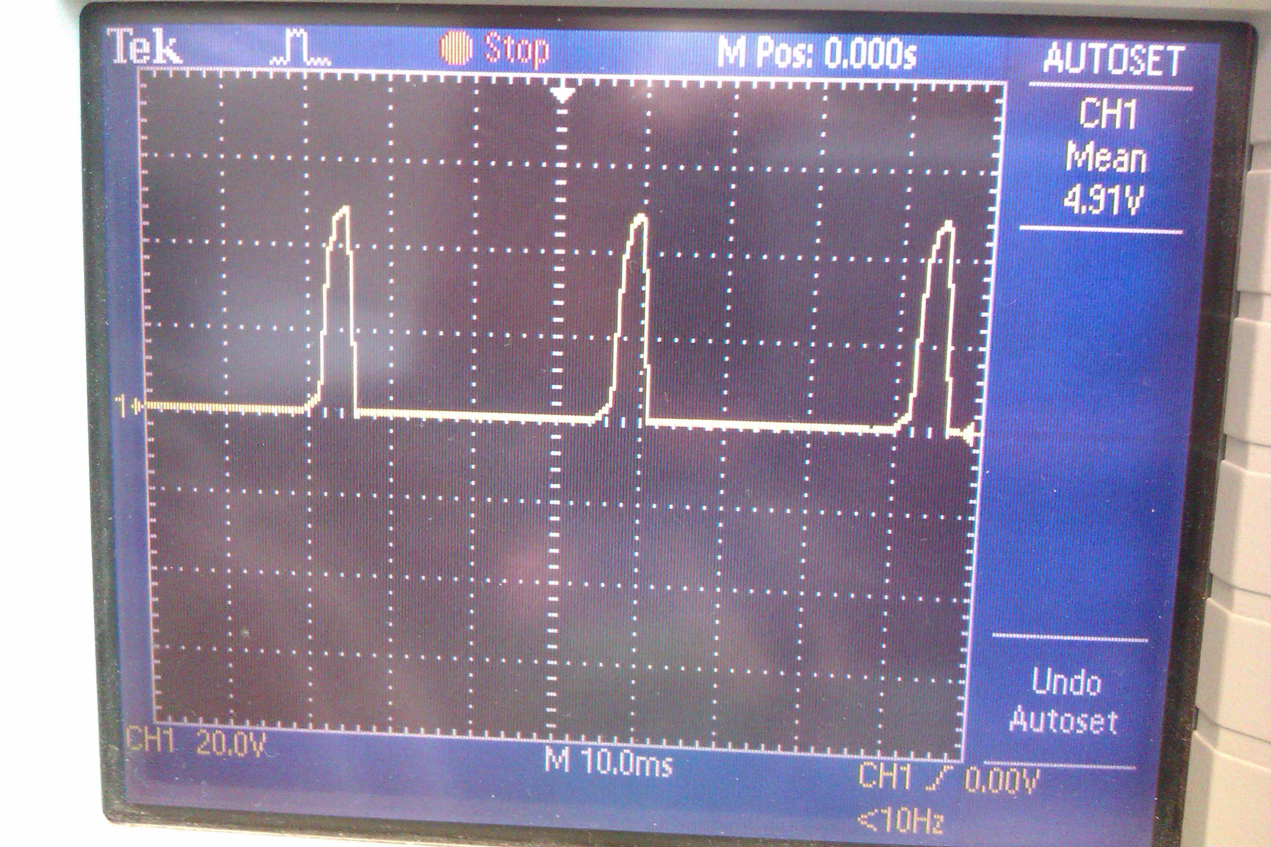

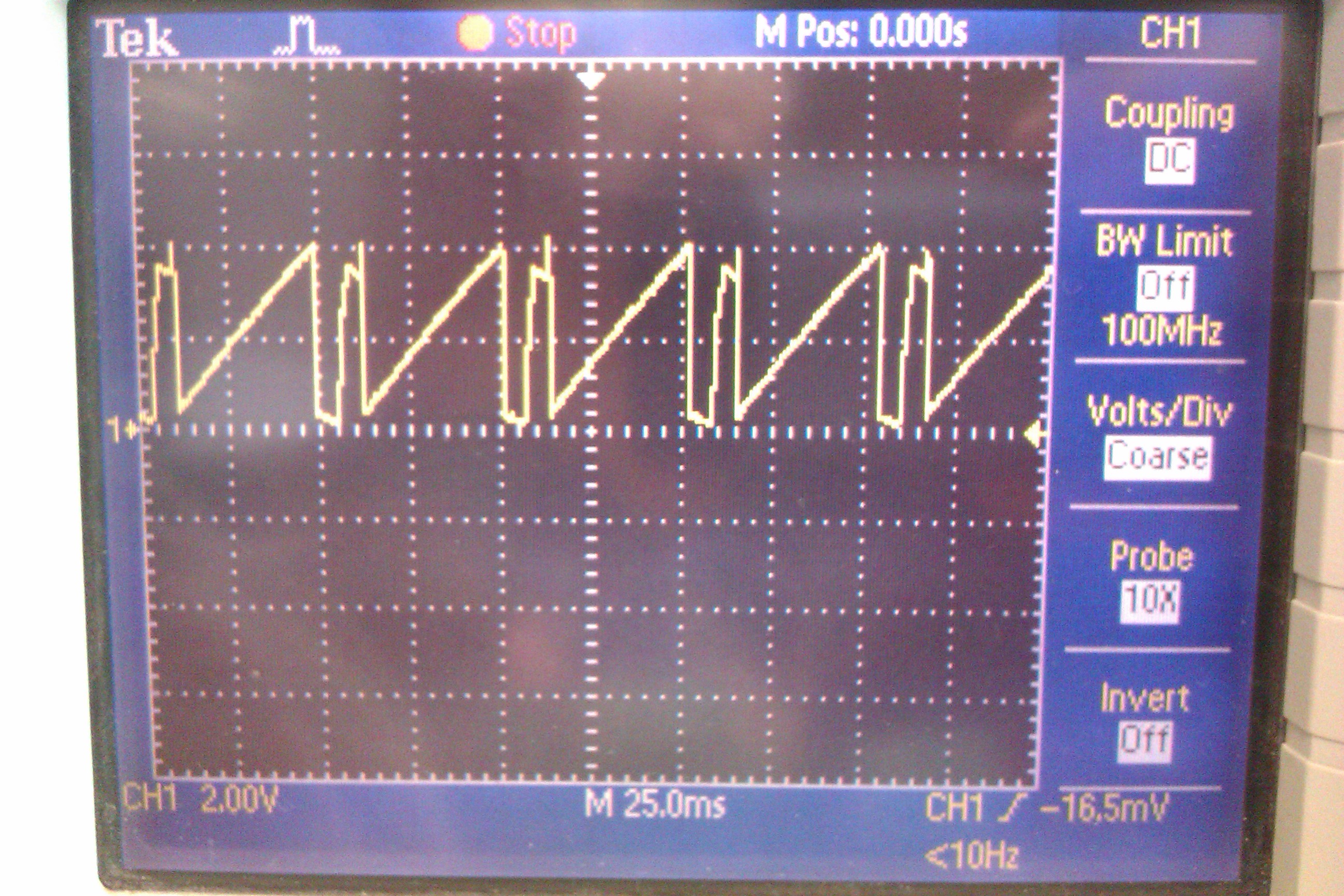

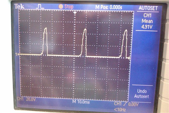

I attached the gate and timer cap voltage measurements.
Max gate voltage is equal to input voltage
What is the reason for not latching off?
(I performed tests in CR mode.)
