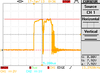

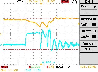

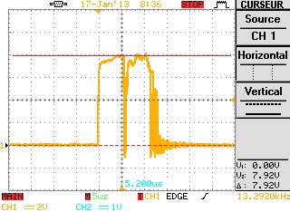

    First of all, i made a mistake in my last report. When i'm between 16V and 24V, everything works fine. I then lower the input voltage from the power supply. When i reach approx. 14V, the system stops but contrary to what i said, the DR output is set to high and i have then a shortcut. So it stops switching completely.
    I guess i know why as when i looked at the Vin pin on the scope, i saw that i had a huge dip close to 5V when the MOS is switching (orange line is the Vin and the blue line is the DR output). This voltage dip seems to be constant whatever the Vin(16 to 24V) or the load. I tried with a 1.6k resistance (300mA @50V) or without any load.
    So i guess that the Vin gets close to 3V for a brief moment and the circuit stops.
    I tried filtering that by changing Cin and Cbp without success.
    My power supply is able to deliver 3A@30V so what could be the problem? I tried changing the MOS. I used one with a better Rds and better Vgs th but it's worse!
    I also tried again with a battery (4Volts) and with a MOS driveable with a Vgs at 3V and i do have the DR output  high (no switching) and the battery voltage is obviously slowly dipping as it is in shortcut.  When i switch the product on, it takes less than 20us for the Vin voltage to settle at 4V.
    Not sure on what to do next. Any advice on what i should  try tweaking?

    Here are the waveforms you ask me.
    With Vin=16V.
    DR output

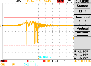

    R sense :

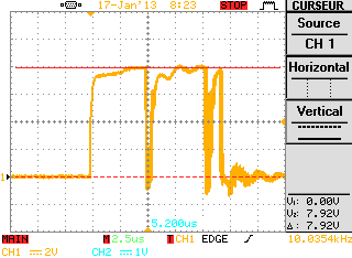

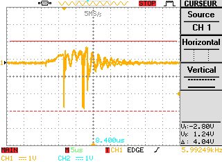

    With Vin=14V (the circuit stops a few seconds later):
    DR output:

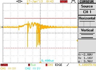

    R sense:
  • Yes, if the input dips to low the part will shut off.  The fact that the battery works means that
    you other input supply is somehow drooping.  I would try shorter and fatter input leads and are
    large electrolytic cap on the input.
    Frank D
