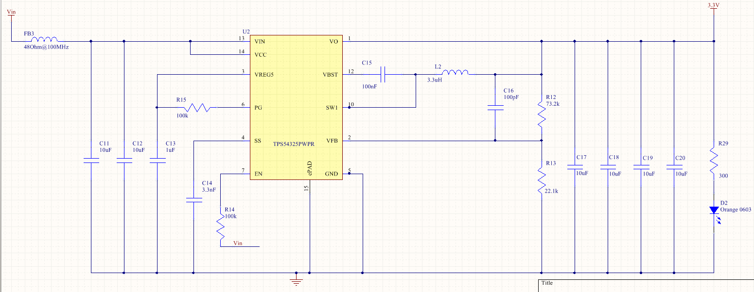

I'm got 2 almost identical circuits based on the TPS54325. One is generating 3.3V and the other is genrating 5.0. The capacitor between Vfb and the inductor is 22pF for the 5.0V and 100pF for the 3.3V circuit. The only other difference is the upper feedback resistor.
Both circuits are fed from the same 12V source and right now I do not have any load connected. The 3.3V circuit fires right up but the 5.0V circuit very briefly come on (no scope on the production floor here but I have a LED on the output). PG is 0V and the high side of the enable pull up is 12V. As soon as I probe pin 7 or the side of the pull-up resistor connected to pin 7, with my volt meter the circuit starts working and stays working until I remove power and try again.

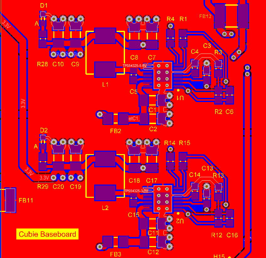

    Here's the circuits and board layout. On the board layout the 5.0V circuit is on top and note that the TPS54325 is rotated (pin 1 is in the lower right corner of the picture)
  • The schematics seem ok.  You might try shorting on the ferrite on the input.  Otherwise I'll have to see some waveforms.

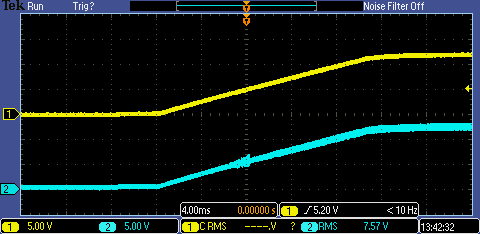

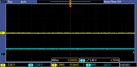

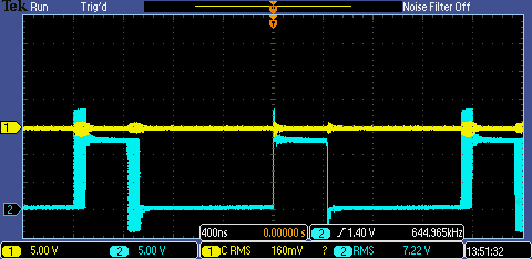

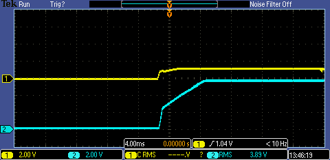

  • OK here's the scope plots, Ground is just on a short wire I attached to the input cap near the 5V Switcher and using 2 alligator clips. Channel 1 is the 5.0V Switcher and Channel 2 is the 3.3V switcher.
    Vin coming from 12V Bench Power Supply
    Vreg5
    Switch Pin
    Vout
  • On your 5 V supply, VREG5 is not coming into regulation.  it should look the same as the 3.3 V supply.  You may have damaged the IC.  Try replacing it.
