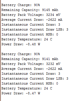

  • Hey Samuel, I got your code up and running but I'm curious if you also get  the single digit readings for the following readings.  Shouldn't these show actual current readings?
    Instantaneous Current Draw: 7
    Instantaneous Current Draw LSB: 7
    Instantantous Current MSB: 0
  • This is test code for verifying the functionality of reading the different status values so may not be 100% functional. I was having issues with the instantaneous current readings because they require writing to the registers in a specific order and sending both the control command and the specific subcommand. This is why I broke out the value into LSB and MSB, for troubleshooting. If I get a chance I'll take a look at the code this weekend and hook my Arduino up to a battery and see if I can figure out why the instantaneous current isn't returning the result in milliamps like the Average Current is.

  • i have all the standard commands up and working now!
    The only thing I cant get to work is the instantaneous current reading.
