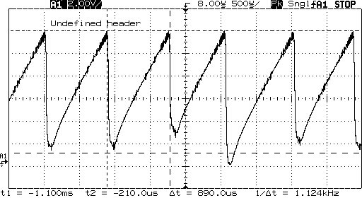

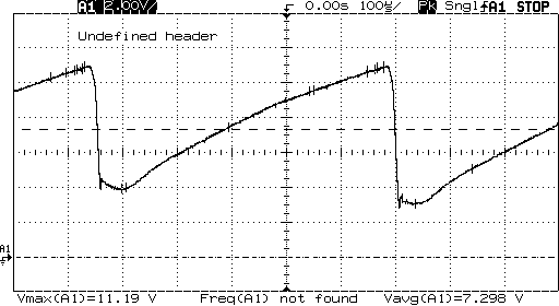

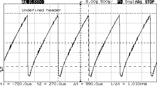

I'm currently trouble shooting a design based around the TPS23756.  It is based on a mix of the various flyback reference design for this series of parts, and is to have an output of 5V/3A.  The result I'm getting on the output is a sawtooth wave from 2V to 12V at a frequency of 1kHz (screen shot attached).  I've double checked the math for all components and made some other tweaks, however I'm having no luck.  If anyone has any suggestions as to where to begin looking it would be appreciated.

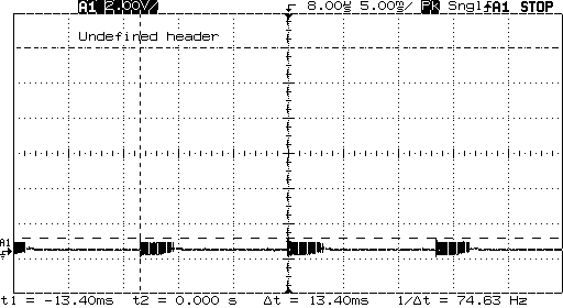

    I have three variants of the same base design using three different transformer cores.  The EP13 and EFD15 variants have similar outputs.  The EFD20 variant I fired up yesterday for the first time, isn't doing much of anything, and I admittedly haven't had much of a chance to trouble shoot it.
    EFD15 Schematic
    6862.AAM_EFD15_SCHEMATIC.pdf
    EFD15 Waveform
    EFD20 Schematic
    1134.AAM_EFD20_SCHEMATIC.pdf
    EFD20 Waveform
    EP13 Schematic
    0131.AAM_EP13_SCHEMATIC.pdf
    EP13 Waveform

    Suggestions based on the schematics: 1. Remove the capacitor from the CTL pin to GND. This is probably the cause of the instability. 2). You may need a resistor between the CS pin and the current sense resistors for additional slope comp (when Vin is low and the duty cycle is high). See the explanation in the datasheet. 3) Start with and/or compare component values against the EVM (or PMP6672) for starters and then you can adjust from there. 4) I did not have a chance to compare the flyback transformer specs of your parts vs. the EVM specs. Compare pertinent specs to see if any large differences appear.

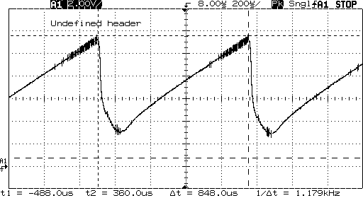

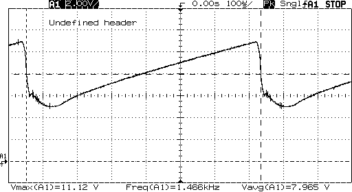

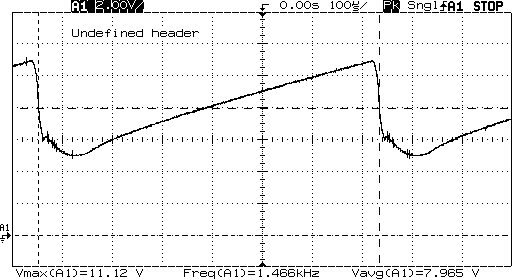

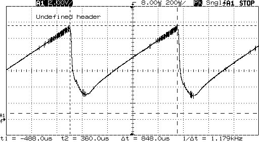

    I removed the cap from CTL to ground, and I'm still unstable.  I added a 3k resistor between CS and the CS resistors.  The waveform changed some, but I'm not entirely sure how to read the change (for better?  for worse? indifferent?).  I'll insert the screen shots at the bottom of this response.
    I have samples of the transformer for the original TSP23754EVM-420.  Tomorrow I'll build up a board from scratch replicating the components as much as I can.
    Original circuit (500 us time division)
    Cap from CTL to ground removed (100us time division)
    Cap removed from CTL to ground and slope comp resistor added (100us time division)
