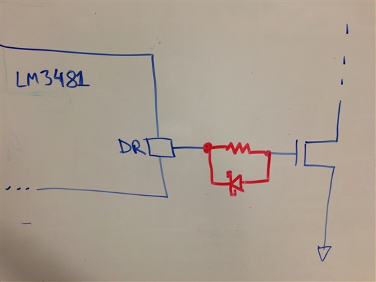

Lastly, to minimize EMI from the switch node, is there a way to control the slew rate of the FET drive? If you have any other suggestions on devices that would address my concerns please feel free to make your recommendations:
