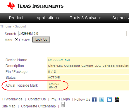

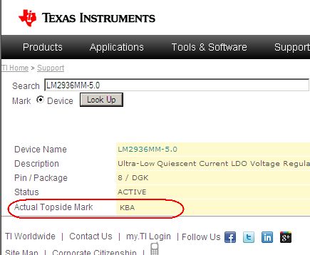

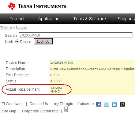

There is mis-match against what is documented at the TI web site for the LM2936M-5 top side marking
Should be LM293 and 6M-5
Your marking shows an extra ".0" in the voltage option.
I need to find a sample here to confirm but I think there should be 3 lines total : Logo&DateCode, LM293, & 6M-5
Only way to know for 100% sure is to have the expoy package etched away to reveal the die.
There is a formal procedure for submitting devices back to TI for failure analysis to get this "de-cap" done. That would need to go through your local TI sales office, or your supplier, since there is some paperwork needed upfront.

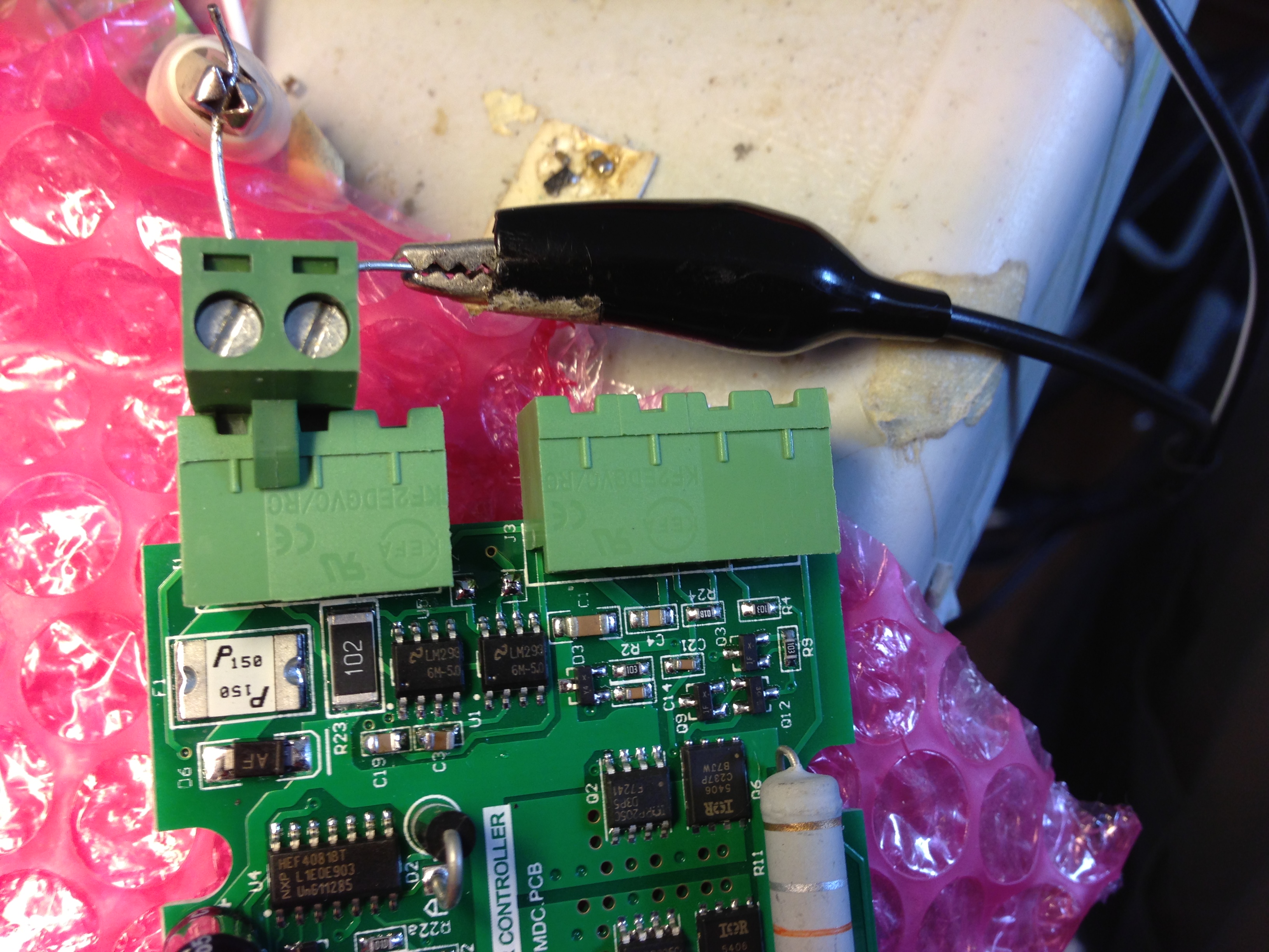

I have received and tested my boards with 25 x LM2936M-5.0 from element14, and 3 x samples from TI.
In most cases the voltages regulators worked perfectly ( low Iq), except for 2 that I found the output capacitor value
was low ( ~ 6uF instead) of 10uF - increasing this capacitance fixed all problems.
All the new ICs were labelled with 3 lines of text, for example :
MZAC
LM293
6M-5
whereas all the Chinese sourced parts had 2 lines of text with the extra ".0"
