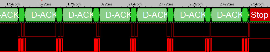

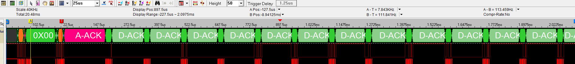

  • Tom
    Thankl you for all your help I have the basic communication running,There are still a few open question I will post when I am more sure that I am missunderstanding the basics.
    To others haveing the same problem in understanding how to communicate to the BQ device with a MCU
    (1) set the mcu as master device
    (2) Confugure the I2C module
    To read the Standard comman set  as a block of data follow the follwoing pattern
    START-0xAA- ACK-.CMD (0x02)-ACK-.START-0xAB-ACK-.DATA (LSB)-ACK-DATA (MSB) [ACK-] [NACK]- STOP
    keep on ACK the data bytes to read the number of bytes (do not send the NACK)you want on the last byte do not ACK but do a NACK and then a stop see screen print of this
    I will post the extended comnmand pattern when completed
