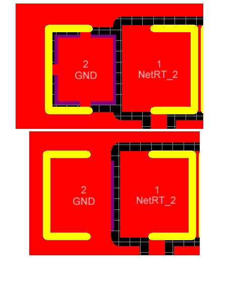

    3) You should remove all relief connects on your board. Relief connects add more inductance. Having continuous copper pour is desirable.

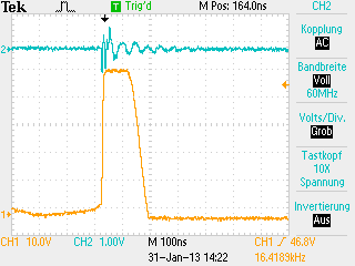

  • Hi
    Hm I found that the Values of C4 and C5 were interchanget with the calculations may this wrong comp setting is the reason of fail ....

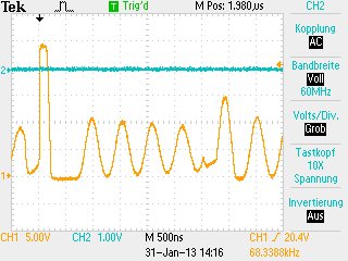

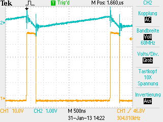

    The left Picture is  1.6A Load CH2 = Cin, CH1 = SW. The right Picture is  no. Load CH2 = Cin, CH1 = SW.

  • The switch output @ no load, looks strange.

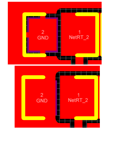

    Thank you for more information. The "relief connect" and "direct connect" terms pertain to the way the copper is poured on the board. Relief connect isolates the component pad from the copper pour area so as to make it easy to solder the component. The pad is connected to the copper on the board through a narrower trace. The thin traces in turn add more inductance in the path and cause spiking. Direct connect does not isolate the component pads and therefore does not add more parasitic inductance. I have attached an image showing the difference. In the attached file, the upper image is an example of using relief connect and the lower image is an example of using direct connect   . You should use direct connect.
    Another thing I had mentioned in the previous message was that the Vin bypass caps (in your case the 1uF and the 100nF caps) should be directly across Vin pin and PGND. The PGND should be connected to the DAP directly. In your layout, the Vin bypass ground is going through a via. Adding a via again adds more noise in the HF current path. Ideally all the switching currents should be contained in the top layer. On your layout the HF current is travelling a very long path. I have attached a presentation explaining the good practices for board layout and mitigating EMI ( 0878.Switching Power Supply Design_ EMI.ppt ). The AGND and PGND pins should be connected to the DAP under the IC as well. It does not seem so from your layout. You would still need some bulk capacitance which can be a little away from the Vin pin, but not too far. Here is a link to a similar post that was answered in the past (http://e2e.ti.com/support/power_management/simple_switcher/w/simple_switcher_wiki/2261.problem-with-lm5576-pcb-layout-issue-dies-on-short-circuit.aspx).
    The Ccomp and Ccomp2 caps should not be swapped. But if they are swapped, you will have an unstable output or the design will not regulate at all. But the chances of it destroying the IC are very low. The last waveform you added shows the DCM mode. At very low loads or no loads, the converter enters the discontinuous conduction mode.  The switch will not be a perfect square wave in DCM. I hope this helps.
