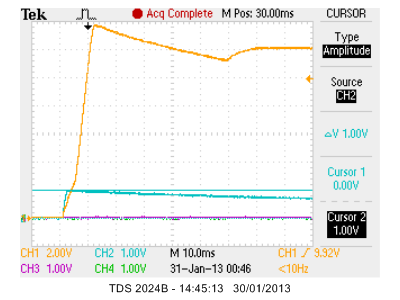

I'm having an issue in an application where I'm using TPS62133. I'm currently working on a switched mode power supply with 12V and 5V outputs. 12V output is provided by an isolated flyback converter connected to mains and TPS62133 steps down 12V to 5V. The 5V power supply is backed up by a Li-ion cell when power from mains is cut off (e.g. fault in electrical grid, mains plug disconnected by user).  A battery management IC steps up battery voltage to 5V when in backup mode, and it recharges battery when in normal mode.
For this application I have used L=2.2uH  and Cout=150uF. Maybe it is not the best, but output is correctly regulated.
It works fine for some hours. But then TPS62133 stops operating. And I can mesure a short circuit between 12V and 5V when the whole circuit is unpowered.
I am pretty sure that the IC is being mishandled, but I have no idea of what is going on. TPS62133 has a short circuit protection and I have never measured any significant overvoltage in the 5V rail, so I really don't know what is the issue. Input voltage (12V rail) peak is about 15V.

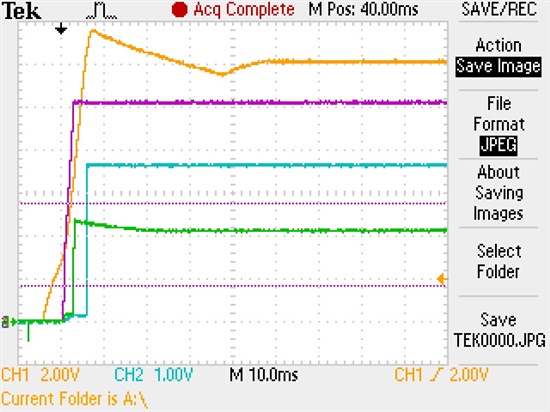

In fig. 1 the circuit is working correctly. Ch1 is 12V and Ch3 is 5V. fig 2 shows the "damaged circuit" operation. Ch1 is 12V and Ch2 is 5V.
Has anyone ever seen something like this?

  • Based on those waveforms, your 12V supply is overshooting past and above 12V.  This is a typical failure of a DC/DC converter powered from an AC adapter typically.  Once the adapter is plugged in, its voltage overshoots due to the inductance in the input cable.  It would be good to see if this ever happens.
    Also, it is worth removing the TPS62133 from the board and seeing if the short still exists on the output.  It could be a downstream circuit that is broken.

    Yes, indeed. It is overshooting above 12V. I may take a closer look at that later. Now I'm concerned about finding the event that causes the TPS62133 failure.
    As it is clearly written in the datasheet, the IC input voltage absolute maximum is 20V... so a 14V overshoot shouldn't be a concern.
    When I remove the TPS62133 the short circuit no longer exists. But when the circuit is powered on, there is no short circuit.

  • 14V overshoot is fine but if it overshoots at all, it likely overshoots more under some conditions.  It is worth looking for.
    Yes, the abs max temperature would be exceeded before the thermal shutdown is reached.  The reason thermal shutdown is set so high is so that the maximum operating temperature can be reached without shutting down.  Good board layout should prevent you from reaching it under almost all application conditions.
