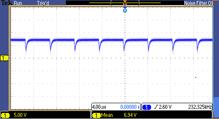

    2) Here I have attached gate drive pulses of MOSFET.It's duty ratio is not 50%.

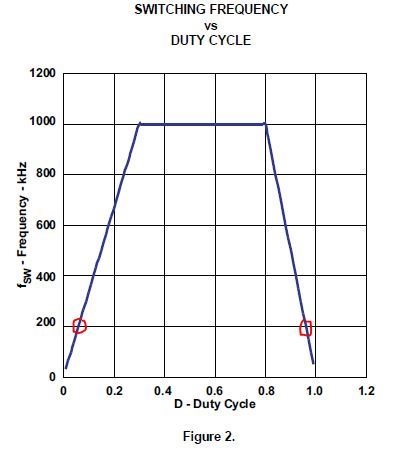

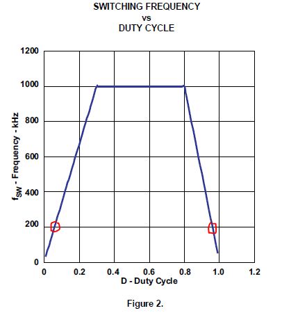

    3) I refer the figure 2  in which for 200Khz , 0.1 or 0.9 duty ratio can be obtained,

    Based on the waveform of your gate drive pulses you are at the maximum duty cycle limitation of the TPS40210. First you may try reducing the the switching frequency even further to see if it helps. You may also try replacing the series 3.3Ω resistor with a 0Ω to speed up the turn on and turn off of the MOSFET. The steady state SPICE models located in the TPS40210 product page could be used to test this out before testing on a real circuit.
    Also you might be misinterpreting Figure 2. The curves show the maximum or minimum duty ratio possible based on the switching frequency. With 200kHz switching the minimum duty ratio is about 0.08 or the maximum duty ratio is about 0.95.
