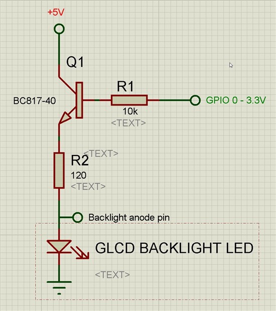

I'm looking for a part that will let me drive the cathode of GLCD.
My project is using a PIC 18F2620, 3.3V powered. With a PIC GPIO i need to drive the GLCD backlight cathode in order to switch On / Off the backlight.
GLCD anode is tied to +5V.
Actually, what part shoud i consider to drive a led powered from +5V voltage with a GPIO delivering 0 - 3.3V ?
Many thanks for your help,
  • I would use an NPN (or NMOS) controlled by the GPIO. 10-47K in series if using an NPN. Then if you know the supply is always 5V, you can find a suitable resistor to place in series with the LED to set the current. 5V-LED-Resistor-NPN-GND, GPIO-10K-NPN-GND.
  • Thanks, but the GLCD backlight can only be driven by anode pin ( cathode is internaly tied to GND )
    Would that schematic be correct to do it ?
    If GPIO delivers 3.3V when active, would it be enough to get Q1 passing the current into the backlight led ?
