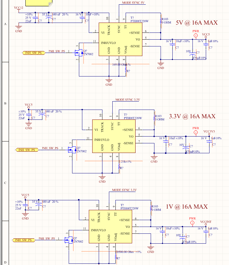

I have a 12v source as an input to PTH08T220W to create a 5v supply.
I am planning on using the 5v as an input to another PTH08T220W to create a 3.3V supply. Also, I am planning on using the 5V as an input to another PTH08T220W to create a 1V supply.
Is it OK to do this? If yes, what are the consequences.
I am doing this because the 12V has a maximum load capacitance of 800uF. And Each PTH08T220W must have at least a 680uF C_IN as recommended by the datasheet.
See attached:

    This application schematic  as drawn  with  (3) PTH08T220W  has many questions concerning output stability( output capacitance),turbo trans function and input capacitance.
    The power supply cascading is not recommended for a number of reasons including stability  and circuit   impedance. The  PTH08T220Wx3 input capacitors when  sharing a common input bus copper plane can be reduced to 220uf polarized +22UF for each regulator.Then the 12V input bus can b used as the input capacitance is less than  800uF.
    a. The total amount of input capacitance is about 744uF.
    Questions on the output bus with turbo trans resistors are:
    1. What is the type( vendor) and ESR on each output 470uF / 10V  polarized capacitor?
    a. The 5V and 3.3V Rtt(turbotrans resistor) must be open with this 470UF capacitance.
    b. If the RTT on the 1.0V module has only one (470UF) ESR < 15mΩ on the output bus and it is a polymer  tantaulum type an d not aluminum type, the  RTT turbo trans resistor is 20.5kΩ.
    2. The Smart sync. if not used must be grounded
    3. The Vout voltage adjustment pin 8 selected resistor for output voltage is recommended to be connected to the (-) remote sense pin 7.The (-) remote must be connected very close  to ground pin 4  within 10cm or less.

  • Hello Tom,
    Thanks for your prompt reply. I now understand that the stability of the regulator depends on the impedance looking back from the output. That's why it is not recommended to cascade. I will use the 12v with 220uF pol as you recommended.
    To reply to your questions:
    1- AVX TAJE477K010RNJ; ESR is 0.5ohm
    a- I haven't decided if I wanted to use the TT or not. That's why I put a 0ohm jumper.
    b- ok
    2- I am using smartsync. the circuit is not show here. the last signal is mode sync 1v not 3.3v
    3- ok
