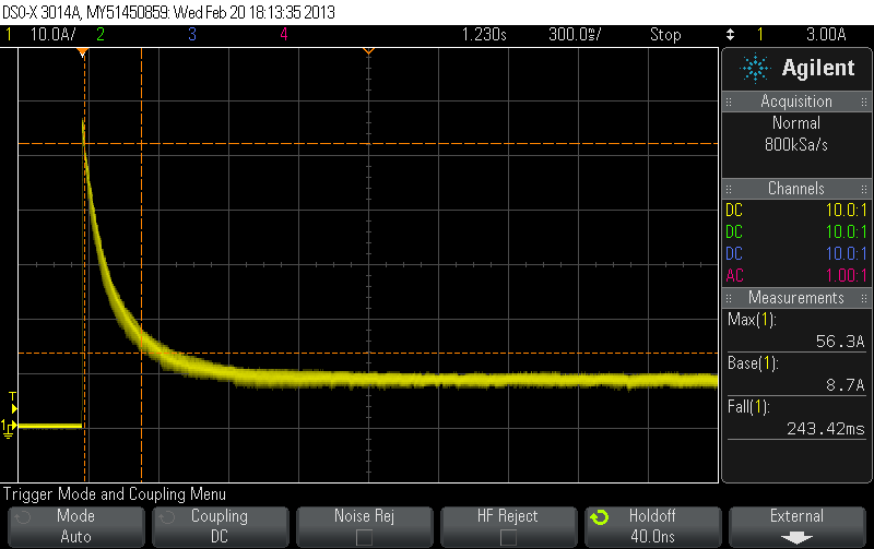

    Thanks for your reply. Problem is within this project, I do not have time to develop a whole new PCB for TI's IC therefore I want to purchase a EVM module with fuel gauge ability. I also attach the graph of current drawn by my device so you may have a look. There is an inrush current at the beginning for about 300ms so I dont think it is gonna be a problem but the continuous current drain is about 8A and I couldnt find any EVM board which could handle it. Only some Li-ion protection solution board has higher max current but then they do not have fuel gauge ability. Do you know if any EVM board from TI fit my requirements?
    Or can I just try to change the FETs on my bq20z655EVM board with a more power one?
    Looking forward for you advices.
