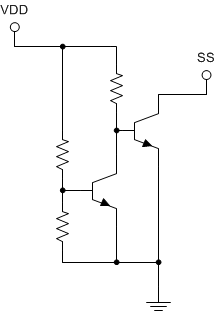

We are using the TPS40200 Voltage Mode Controller in a 50 VDC input voltage application.
We must ensure that the output does not start switching (SS must be held low) until the input reaches 30 VDC. If SS is not driven low the output starts switching at an input of  ~5.5VDC.
The voltages available for this hold down circuit are the 0-50 VDC. One idea was a comparator with one input fed by the input voltage through a resistor and held at a level using a zener diode and one input on a voltage divider fed by the input voltage. The VCC for the comparator would also be held through a resistor with the otther end tied to the input voltage using a zener. The initial problem with this is the VCC must reach at least 3 VDC before the the input reaches ~5.5 VDC so the resistor must be a fairly low value. The application is very low current and consumes too much current through the resistor and the zener.
David Robinson
  • Hi Dave,
    One idea I have is the circuit below. When VDD is too low, the transistor on the right conducts pulling SS to ground. Once VDD pass the threshold determined by the resistor divider, the transistor on the left conducts turning off the right transistor and floating the SS pin.
    Any thoughts?
    Anthony
  • Hello Anthony,
    We prototyped it and adjusted the resistor values. So far so good. Thank you for the input.

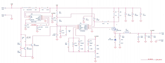

  • Hi David,
    I'm surprised the transistor circuit is causing issues here. It appears the circuit is some how causing the part to falsely trip over current protection and get stuck in hiccup mode during the input transient.
    Can you share a schematic? Also a screenshot of the VDD voltage and SS voltage during the break and make situation may help. Both with and without the transistor circuit if you can.
    Anthony
  • Hello Anthony,
    I will start with the schematic.
    How do I send it to you, email?
    I am not sure I should post it publicly.
    David Robinson

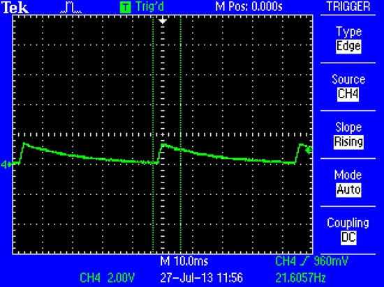

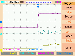

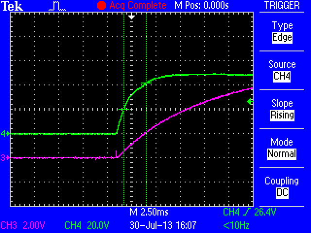

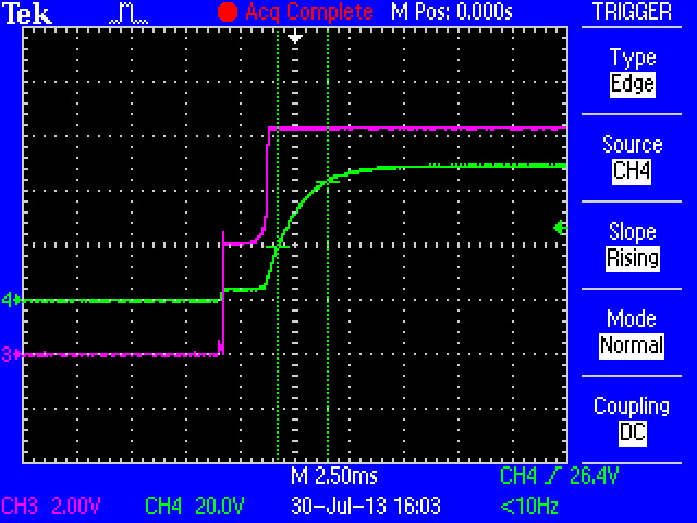

  • Hello Anthony,
    Make Situation:
    This first image is the VDD (green) and SS voltage (violet) without the transistor circuit connected to the SS pin.
    This second image is the VDD (green) and SS voltage (violet) with the transistor circuit connected to the SS pin.
    The TPS40200 entered hiccup mode after this image was collected.
    David Robinson
  • Interesting, so the hiccup mode is not entered right away. Does anything abnormal happen to VDD or any other signal when the SS voltage begins the hiccup waveform? It also looks like the transistor circuit is not holding the SS pin below 100mV until VDD reaches the threshold like it should.
    In the first waveform without the transistor circuit, is the 0.1µF cap still on the SS pin? The SS ramps up very quickly. The VDD waveform is also not very smooth in this screenshot, does it always look like this or is it a result of how the VDD power supply is turned on?
  • Hello Anthony,
    I agree it looks like the transistor circuit is not holding the SS pin below 100 mV until VDD reaches the threshold like it should. Perhaps this is because the transistor circuit is power up by +VIN in the schematic? +VIN is essentially the same thing as VDD though an inductor.
    The transistor circuit switches high when VDD is at about 26 VDC. I just found that if I slowly vary the VDD voltage around 26 VDC in the range of about 24 VDC - 28 VDC that I can pretty easily enter and get stuck in the hiccup mode. I found the only way out of this is to decrease the voltage and transition high somewhat quickly.
    In the first waveform mentioned above without the transistor circuit the 0.1 uF capacitor is not connected to the SS pin.
    David Robinson
  • Hello Anthony,
    This remains as a problem.
    Any feedback would be appreciated.
    David Robinson
  • Hi David,
    After taking a bit of a closer look at your schematic I noticed the filtering at the ISNS pin is a bit unusual although I can't think any major cause for an issue yet. The 20.5 ohm resistor is in series with the RC pin and with the filter cap to ISNS. The 470pF cap should be connected directly from ISNS to VDD. What happens if this resistor is 0 ohms instead?
    I also wonder if it was not disconnecting the transistor circuit which solved the issue but that you disconnected the 0.1µF SS cap. If there is only this 0.1µF with Q4 disconnected from the SS pin, does the issue appear again?
    Is there any load on the output? The 50mΩ sets the hiccup threshold at about 2A peak current. Which might be about 1.5A average load current not including any current needed to charge up the output capacitors during startup.
    Anthony
  • Hello Anthony,
    We replaced the 20.5 ohm resistor with a zero ohm resistor and the result is the same.
    When Q4 is disconnected the situation is changed because the Q4 is the circuit that holds the SS pin low until the input is at 30 VDC.
    We did do another experiment with the SS pin after it was disconnected from the Q4. This was we connected the SS pin to ground after the input was at 30 VDC and then released it and we noted that we were able to get into the hiccup mode pretty easily in this setting. If we touched the SS pin to ground and quickly released it we went into hiccup mode.
    The load for this circuit is a microcontroller and some supporting circuitry that draws about 5 mA.
    David Robinson

  • Thanks for the layout David. Can you also add the copper and vias to the layout pdf?
    Looking at this there are a few things which could be causes. The FET is right next to the noise sensitive VDD and ISNS pins, even closer than the bypass capacitors. There is a good chance these are picking up the switching noise. If you look at the EVMs, C9 would be located right next to the two pins. Also C8 is right next to the IC similar to where R10 is currently placed.
    I also noticed the Inductor and FET are on opposite sides of the IC. How is the switching node routed?
    Are the snubber values listed on the schematic the ones actually used? Another thing to try without needing to change the layout is to increase the 68pF to 680pF to reduce the noise.
    One theory I have why removing the transistor circuit is causing nuisance tripping of the OCP is that it delays turn on to a higher VIN. At higher VINs there is more noise due to switching because the switching node is transitioning between higher voltages. The extra noise combined with the current needed charge the output capacitors is leading to OCP tripping.
  • Hello Anthony,
    The copper is attached.
    I am pretty sure the Inductor L2 and FET Q2 are on the same side of the IC but there is a mounting hole in between them.
    The 68pF is the snubber value. I will try the recommended 680pF next.I agree with your theory. I will try testing it at different input voltage to see at what point the nuisance tripping stops occurring.
    David Robinson
  • I see now. I had overlooked L2 because of the footprint and was looking at L1. Some more comments below.
    • The VDD trace goes right underneath the FET, this is very likely getting extra noise. If you change the layout I would move the FET away from the TPS40200 and put the ceramic VDD cap right next to the IC with a short return path to the GND pin.
    • The switching node trace to the inductor is very thin. We typically make this wider to reduce the inductance.
    • The trace from the sense resistors R8 and R9 to the source of the FET is also very thin.
    • Please the ISNS to VDD cap right next to the two pins.
    • The SS cap and RC cap should return to the GND pin of the TPS40200 before connecting to the internal GND plane. This can be done by adding a seperate GND copper pour. This could also be used for the GND of the ceramic VDD cap.

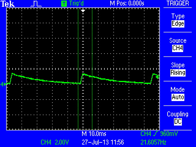

  • Hello Anthony,
    Attached is the scope shot of the output Channel 1 on scope and the SS pin Channel 2 on the scope.
    The SS pin has the saw-tooth hiccup wave-shape on it. The output is fixed at an unacceptable level.
    The behavior of the current configuration is worse than the previous one in that we go into hiccup mode almost every time we power up.
    We will remove the transistor that is connected to the SS pin to determine if the device goes into hiccup mode when the SS pin is manually connected.

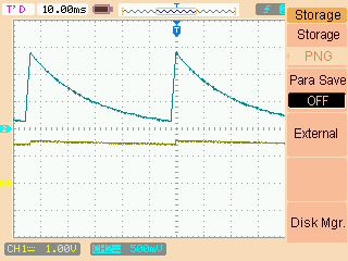

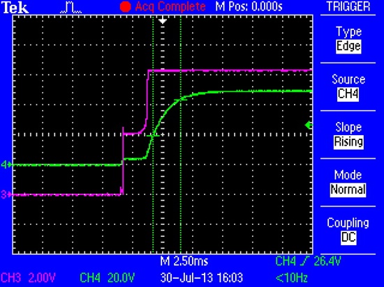

  • Hello Anthony,
    Attached is a scope shot of the TPS40200 output (Channel 1), SS Pin (Channel 2), the +HV value (Channel 4) 48.2 VDC, and the other end of the 221 ohm resistor (Channel 3) 49.1 VDC.
    This shot shows a voltage drop of 49.1 - 48.2 VDC = 0.9 VDC.
    David Robinson
  • Hello Anthony,
    + HV (Channel 3) does not have overshoot when hiccup mode is initiated.
    David Robinson
  • Thanks for the waveforms David. For comparison, could you take one with the SS cap remove where hiccup is not initiated?
  • Hello Anthony,
    SS capacitor removed and no hiccup conditions.
    Attached is a scope shot f the TPS40200 output  (Channel 1), SS Pin (Channel 2), the +HV value (Channel 4), and the other end of the 221 ohm resistor (Channel 3).

  • Hi David,
    Thanks for the additional screenshots. It looks like there is some triggering of the hiccup mode when the SS cap is removed. However the output is able to reach the regulated 3.3V because the hiccup time period is so short.
    Do you have a copy of the spreadsheet you used to set the compensation? I noticed the value of R18 is about 10 times smaller than usual. I wonder if this is making the hiccup current limit more sensitive such as a slow response speed leading to a high peak current.
    Anthony
  • Hello Anthony,
    I received the attached from Richard Elmquist on 7/13/2013.
    David Robinson
    Robinson_7_3_12_TPS40KType III Loop Stability kVenable_sluc263c.xls
  • Thanks David! I noticed one input error in this and the compensation could be improved. R_1 was set to 10k instead of 100k.
    Can you check if you see any improvement with C18 = 136pF, R19 = 7.9k, R18 = 63k, C17 = 233pF, and C19 = 18pF?
  • Hello Anthony,
    Is R_1 internal to the TPS40200?
    David Robinson
  • R1 is the top FB divider resistor.
  • Hello Anthony,
    Please see the following:
    C18 = 130 pF
    R19 = 8.06K
    R18 = 63.4K
    C17 = 220 pF
    C19 = 18 pF
    Is this close enough?
    David Robinson
    David Robinson
  • Yes, that is close enough.
  • Hello Anthony,
    We mounted the new components. The SS pin capacitor is not installed.
    Attached is a scope shot of the TPS40200 output (Channel 1), SS Pin (Channel 2), the +HV value (Channel 4), and the other end of the 221 ohm resistor (Channel 3).
    David Robinson
