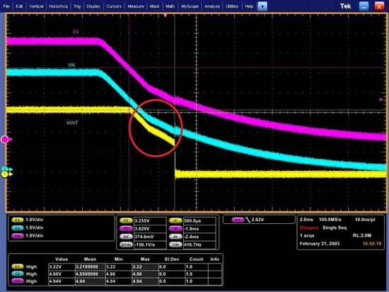

Does anyone help to explain why Vout goes down with a step(marked in red) when Vin and EN is down? And why after the step Vout is going to 0V very fast?

    How is this measurement tested and what is on the load? We will need more information. Just from guessing, it looks like a different discharge profile, probably from the load turning off at that voltage? The large step is the LDO reaching is UVLO and shutting down. Does the customer have a problem with the little bend? If the LDO is disabled before dropping vin, you can get a more monotonic shutdown.

      This waveform was tested on TPS7A8001DRBEVM. EN is connceted to VIN. VIN=5V, VOUT=3.3V with static loading 1A. I suspect the bend show LDO is in the dropout region where VOUT is proportionally following VIN and the large step is in the off region. Correct?
     ' If the LDO is disabled before dropping vin, you can get a more monotonic shutdown.' From the datasheet as below, should the LDO be disabled when EN is lower than 0.4V?
    Enable high (enabled) Min 1.35V
    Enable low (shutdown) Min 0V , Max 0.4V

    Yes, EN is shutdown when VEN is below 0.4V. Please see below shutdown waveform.
