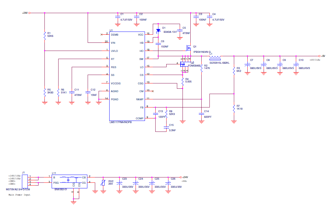

I have made a design with the LM5117 IC to make a converter from 24VDC to 5VDC 15A.
I have used the Webbench to calculate the design. My problem is that if I use the 680uF/6.3V capacitors on the output side the output is very noisy. I have then changed to 680uF/25V and then the output looks much nicer.
The next strange thing is that if I draw more than 7A the system starts to "reset all the time. I have seen several posts in this forum about the same problem but none that had a solution.
Can anyone help?
Morten
  • Hi
    Looks like your ESR zero is close to the crossover frequency. Please try 267kOhm(R8), 33nF(C15) and 390pF(C13).
    I think the reset issue might be caused by noise due to PC board layout. . Please try sunbber.
    I also found there is no Cvin. Please place Cvin as close to the device.
    Input filter sometimes cause an instability. Please try  without the input filter.
