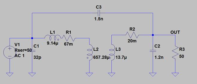

Transformer
I’ve analyzed the power transformer in detail, looking for a project error. This transformer is custom made, since our isolation requirements are 3750VAC. The real transformer model is below:
V1 and R3 are test parameters for simulation.
My first assumption was that the secondary series resistance was causing this low efficiency, since the I^2*R power dissipation would be 2,88W at maximum output power (12A). A new transformer was made, with lower series resistance (5mOhms) and no change was noticed.
 Reading the slup081, I started to consider the leakage inductance (9.14 uH) as the main problem. So, I’ve changed the transformer just in case and started using the PA0810NL from the EVM. The result is worse (76% eff max and a lot of instability) for now, since I have not changed all the parameters.

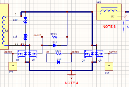

Switching Mosfets

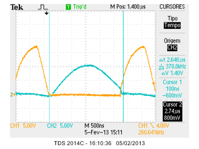

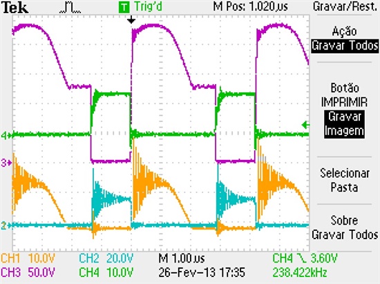

Checking the waveforms from the switching FETs, the shape of the gate of the four main FETs seems a little rounded, which could be from a high input current. Although I’ve tried to reduce this value, this was not possible.
 The primary FETs are SiHF840LCS-GE3 and the Synchronous Rectifiers are IRFH5302. Their output capacitance, which could result in switching losses, are minimum (170pF for the primary FETs and 860pF for the SR FETs)
Synchronous Rectifiers and Test Points used

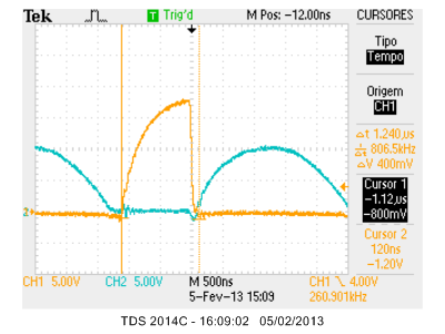

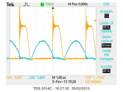

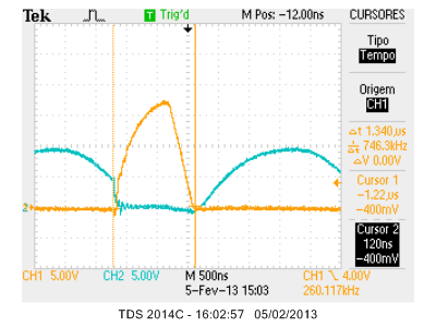

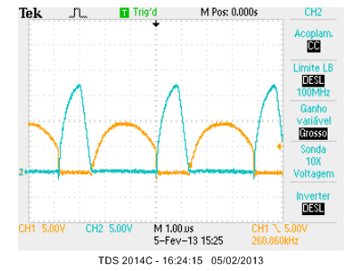

Yellow - PT1, Blue - PT6, 5% Load
Yellow - PT1, Blue - PT6, 100% Load

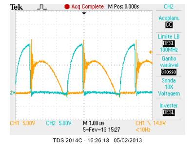

Yellow - Qf (TZ8) VDS, Blue -  PT1, 5% Load
Yellow - Qf (TZ8) VDS, Blue -  PT1, 100% Load
Yellow - QR (TZ9) VDS, Blue -  PT6, 5% Load
Yellow - QR (TZ9) VDS, Blue -  PT6, 100% Load

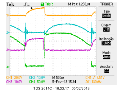

Yellow – PT1
Blue – PT6
Purple – Main FET Gate
Green – Aux FET Gate (clamp)
5% Load
Yellow – PT1
Blue – PT6
100% Load

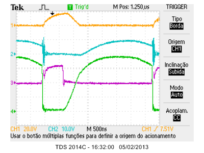

  • Also, why is the Current Slope resistor changing the effciency at light load so much? If I use a lower than the calculated value, the efficiency goes from 7% to 18%, although the heavy load efficiency remains the same...
    I would expect your switching waveforms to be much sharper. Look for capacitive loading on the transformer secondary (TZ8 and TZ9 ???), secondary leakage inductance??
    The waveforms do not look right.
    John
  • Hi John,
    Thank you very much for your reply. I would expect that too, but I could not find a way to get a sharper wave.
    The secondary output capacitance is two low ESR 1800uF capacitors, since this SMPS need to handle a high inrush current.
    TZ8 and TZ9 are TVS needed to suppress high voltage surges (our requirement is 4kV differential mode surge). I removed them in my tests to ensure that they are not acting and reducing the efficiency.
    The waves that refer to TZ8 and TZ9 are measurements made on the secondary, since they are parallel.
    The first 5 waves are the SR gates voltage with a 22R charging the gate capacitor. I've reduced the resistor up to 2R2 and still got no positive result.
    The forward rectifier seems weird to me. Maybe the SR mosfet capacitance (~1nF) is affecting the waveshape.
    One more time, thank you very much for your reply!

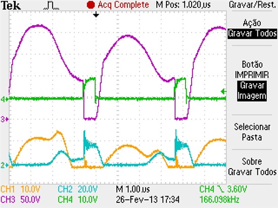

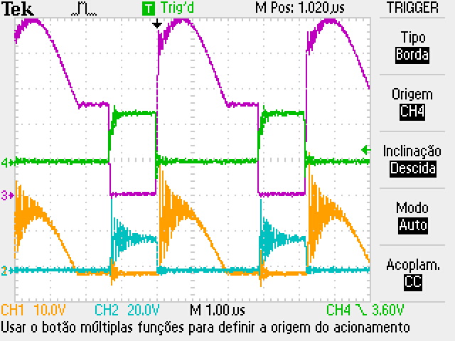

    Anyway, I tested the ultra fast diodes and found an interesting thing: The minimum load efficiency increased, but the high load decreased. Although, the minimum load waveforms went nuts.

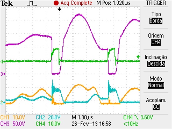

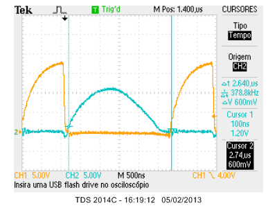

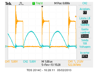

    In the figures below,
    Yellow: Reverse Rectifier
    Blue: Forward Rectifier
    Green: Main FET gate
    Purple: Clamp
    The first one is at full load, and the second one is at light load.
    Beside the fact that it could bring me troubles on Load Share configuration, my guess is that the problem is not the sync rectifiers.
    Any other suggestion? Unfortunately, I'm out of them :(
    Guilherme
  • Hi Guilherme,
    The upper waveform looks more like resonant reset than active clamp. Is the clamp FET working correctly?
    John

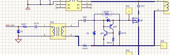

  • John,
    Thanks for your reply!
    My mistake... I was testing with a snubber before, and forgot to change. Here are the updated images, same points of measure:

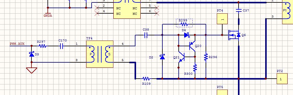

    I agree with you, the clamp is a little bit weird. But it does not act this way when I use the SR (on the two last images from the first post, green line). My gate drive circuit is this:
    Guilherme
  • Guilherme,
    It looks to me that the transformer is resonating with the total capacitance hanging on the windings at a frequency near the switching frequency. You need those transitions to be much faster.
    John

    I've already changed the transformer three times (including using the Pulse PA0810) and saw no difference... Unfortunately, no changes (using the Pulse transformer, the efficiency went down).
    My guess is that the clamp FET is not saturating, or the active clamp is not working correctly. I get the same efficiency results using a dissipative snubber. I'm checking the gate drive circuit right now.

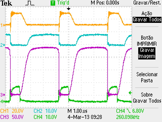

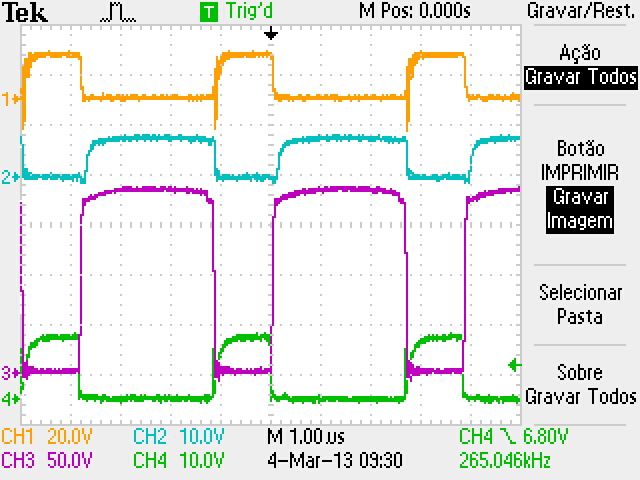

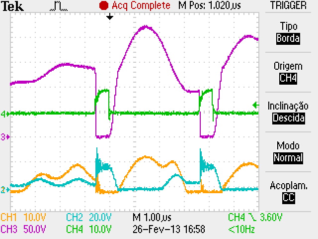

  • Hi John,

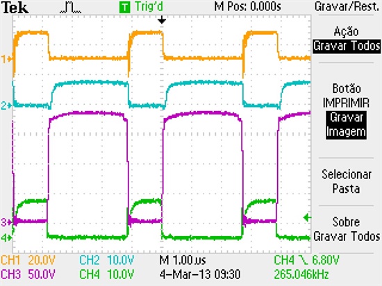

    Sorry for the late reply and thank you very much for all the help you are providing me.
    Here are the new waves I've got. You see, they are much sharper now than later. But my efficiency went down to 74%. I have no other idea of what could help me get a higher efficiency.
    The first image is with 5% load, and the second at full load. The waves are:
    Yellow - Forward Rectifier Gate
    Blue - Reverse Rectifier Gate
    Purple - Active Clamp FET Gate
    Green - Output FET Gate
    Kindly Regards

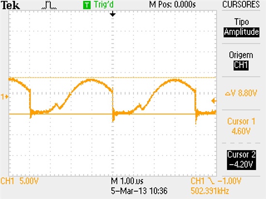

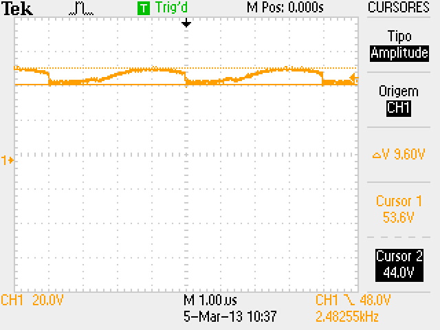

  • Hi Guilherme,
    When the main FET turns off under light load it takes a long time for the voltage on the forward rectifier to turn off. This should be fast. This possibly means that the primary side FET is not turning off properly.

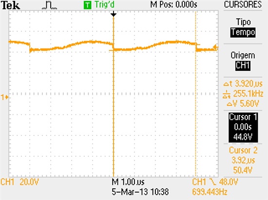

    What is the voltage across the clamp capacitor druing the cycle? How much does it vary?

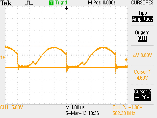

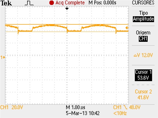

  • Hi John,
    Sorry for the late reply!
    The capacitor is a 10nF 250V.
    Below,
    1) Voltage
    2) Frequency
    3) Detail in AC Coupling
    4) Full Load
  • Guilherme,
    Please attach a full schematic preferrably in PDF form. Mark where each of the scope shots above were taken on that PDF either by identifying a junction or a part number and terminal.
