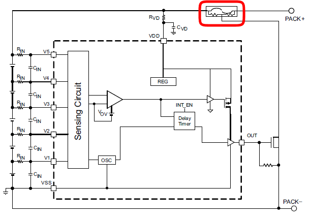

I have one question from "FUNCTIONAL BLOCK DIAGRAM" of BQ77180x datasheet.
What is this in the red rectangle as below??

This is a three-terminal fuse.
See:
The poorly-drawn transistor open in case of over voltage in one or more cells. The current heats the fuse opening it.
