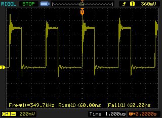

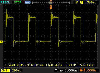

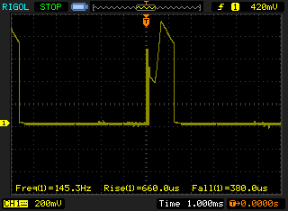

I brought the EVM about a week ago and connected it up today to give it a quick test but having problems getting it to work right.
With no load on the output, input voltage is reflected directly onto the output voltage, until it gets to 12V. anything over 12V input and its 12V output. This would seem normaly, however, when I place a 33R load resistor on the output, the voltage simply drops to about 6V.
The only way it will power the 33R load at 12volt is with at least a 25V input. Anything over 25V and it still works, and the current pulled starts to drop, which seems normal too.
As far as I understood, the board should work from about 5V to 75V input, but it only seems to be working from 25V to 50V input range ? Am I doing something wrong or is this board a duff ?
