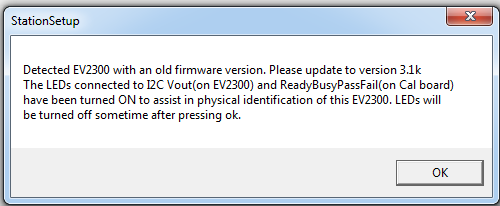

I have an Advanced BQMtester board, HPA495 REV A and I have installed the Advanced BQMtester SW version 2.18.  SW installed correctly. All hooked up and connected to EV2400, HPA 500 REV A. When I try to run BQ tester station setup.exe I get this error message.
Any idea why?
Does the Advanced BQMtester SW support the EV2400 or only EV2300?
I have been using the EV2400 together with BQ20z65 EVSW and this is working perfectly. I have run the EV2400 support components SW. Running it all on Windovs 7 64 bit.

    The bqMTester does not work with the older devices, including the bq20z65. You will have to used the EV2300 for proper communications.

  • Just to clarify things, I do have the Advanced BQMtester and the the datasheet for this, SLUU397A states the following:

    So I thought that this would include the BQ20z65. Is this not right?

    Thus I assumed I could use EV2400.
    From the error I get it looks as if the SW can’t communicate with the EV2400.
    Does the Advanced BQMtester SW 2.18 only work with EV2300 and not with EV2400?
