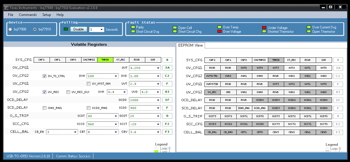

HI. I have a question.
What is a problem if the RED signal is turning on like on the Picture? I couldn't charge the pack anymore.
I think bq77910a is on the fritz. Is that right? How to avoid this problem?
  • The part is seeing a simultaneous under voltage and over voltage.  There may be some contamination on the board causing 2 cell input pins (VCx) to pull together causing one cell to see a low voltage and one or both adjacent cells to see a high voltage.  Resistance to ground on a pin can also cause a high & low cell input voltage.
    If the part has been damaged by application of a voltage above abs max to the inputs, either on the single ended or differential limits, the pins could develop a resistive short to each other or to VSS internal to the IC.  This can also cause the simultaneous UV and OV.  Sometimes only 1 shows up depending on the applied voltage and severity of the damage.
    With the EVM a risk is removing the cell simulator with power applied to the board.  When one contact breaks at the end of the resistor divider, the inputs are pulled to the supply voltage by the remaining connection.  When wiring a board with separate cell connections, touching the cell tap to the wrong input can impose a high voltage on an input.  A tool or fixture path to ground could impose an unexpectedly high voltage on a cell input and potentially cause damage.  If connection is made with a connector and the wrong pins can contact during connector alignment, damage could occur with some combinations.
    While no input should exceed abs max, the VC1 and VC7 have shown to have some sensitivity to transients and were protected on the EVM.  Some users have indicated VC10 is also easily damaged and some protection on this pin may be needed.  Consider the system operating environment and what protections are needed and if it is on the product board or in the assembly fixture.

  • Hi Thank you for Reply.
    I checked some faulty BMS applied BQ77910A. Most of BQ77910A were damaged at VC10.
    I think some PROTECTION on this pin  may be needed, Please advise on how to protect damage.
    thanks.
  • It would be best to determine the cause of the damage to know if the fix is effective.  If it is a cell transient during operation better filtering may help, if it is during connection, a fixture voltage limiting system may work and avoid cost in the product.
    In the bottom up connection sequence mentioned above, connections are assumed to make and stay connected.  When battery- is connected and remains, but the others connect and break sequentially bottom up, the VC10 voltage builds up.  Assuming a 4V/cell voltage, 4V, then 6V, then 7.33V...
    A zener/TVS on the lowest cell input will likely prevent the damage. You must pick a compromise between leakage and protection.  You would like zero leakage at normal cell voltage and clamp below the device VC10 ABS MAX limit of 5V, but ideal diodes don't exist so you must select a compromise. A zener clamp at VC10 would be more certain, but since abs max is 5V and the pin must swing to an induced voltage above this in normal balancing operation, the designers/datasheet author have given us a negative margin for selecting a zener.   If balancing is not used, a zener may be (more easily) placed on VC10.
    The zener on the cell input would clamp the cell transient if it is due to operation so that less comes through the filter.  It will also limit the voltage at VC10 during conneciton because once the diode conducts current will flow through the input resistor and diode to prevent excessive voltage build up on the capacitor.  VC10 can still see the voltage of the diode plus the voltage across the resistor.  If your zener diode limiter can be fixtured to the board during cell connection and removed after, it could be placed on VC10 for a more restrictive limit, then removed before operation.
