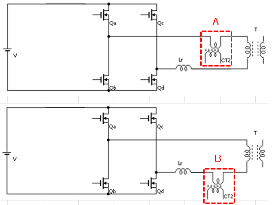

  • Hello Mike-san,
    I am Sonoki's colleague and I want to ask about position of CT current sensing winding.
    (1) Which position do you recommend, A or B? (Is there any recommendations?)
    (2) Is there any reference design under this CT position?
    Typical application(datasheet p.1) shows CT is connected to the top of the full bridge, but my customer wants to put CT winding at this position.

  • I think is not a good idea to put the CT in series with the primary of the main transformer.
    The high dV/dt will cause high peak currents through the capacitance of the transformer.
  • I think it is not a good idea to put the CT in series with the primary of the main transformer.
  • I agree. The best place to put the CT is that used in the UCC28950 EVM - ( TI document sluu421a - sketched below ). Positions A and B are both bad choices and I would discourage putting the CT in either of them.
    There are three reasons for this -
    First. In the positions A and B shown earlier - there is a high dv/dt from primary to secondary of the transformer. This will drive currents across the capacitance from primary to secondary and so cause spikes on the CT output waveform. Spikes in the CT output waveform can cause unstable circuit operation. Additional filtering will be needed to attenuate them but too much filtering can attenuate the wanted current signal. If the transformer is in the position C (below) there is no dv/dv across the transformer so no currents through the primary to secondary capacitance.
    Second: In the positions A and B, a proportion of the discharge currents which flow during the ZVS transitions (as the bridge is going from one switching state to another) will flow in the CT primary and cause additional interference on the CT output signal. These are the currents which charge and discharge the stray capacitance at the switched nodes. These currents do not flow in the CT if it is in position C.
    Third: If the CT is in position A or B it takes up PCB space that is better used to reduce the size of the switching loops around the bridge circuit. Smaller loops will give rise to cleaner switching waveforms and lower device stresses (peak voltage stress). Smaller loops will also cause less radiated and conducted EMI.

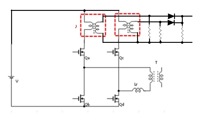

  • The only problem of position C is that the time to reset the transformer is critical. If the duty cycle is near 100% and the current transformer has too much parassitic capacitance, reset of the magnetizing current may be difficult. This is one reason why people has the temptation to put the CT in position A or B.
    If we put TWO transformers, one of each drain of Qa and Qc, we have a full half period to reset the transformer, so any CT will work with a duty cycle close to 100%.
    I tried this and it seems that it works. Your comments will be appreciated.
  • Yes, I've seen this done and it works. The disadvantage of course is the cost of two current sensing transformers.
