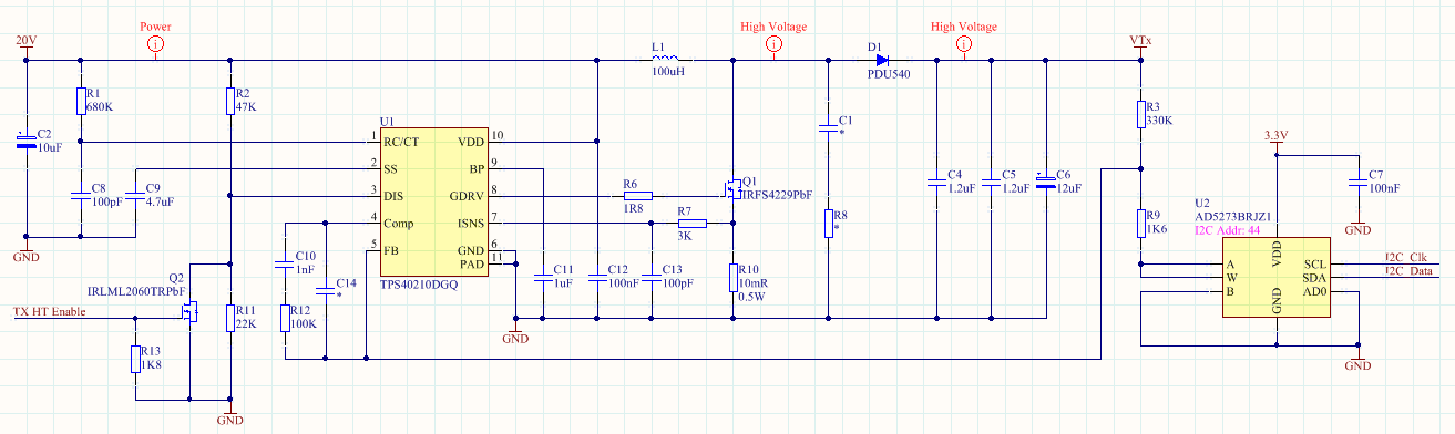

Hi All,
I have a TPS40210 design boosting from 20V up to 120V. When running, the controller IC temperature is around 80 degC, the inductor and FET are around 45 deg C (Ambient is about 20 deg C).
Although 80 in spec for the controller, we need to run the circuit at an ambient of 60 deg C, which may push the IC temperature towards its limit. Are there any non-mechanical (ie. not heatsinks) tricks or circuit alterations that can be used to reduce the IC's running temperature?
Switching freq: 240kHz
Inductor size: 100uH
Output current: 100mA
Many thanks
Andy

    The majority of the losses in the IC are gate drive losses. Two recommendations to reduce the temperature are below.
    1. Make sure the thermal pad is soldered down properly with the recommended footprint and vias given in the datasheet. Also use as much PCB area as possible and connect this to the thermal pad to aid with heat sinking.
    2. Lower the switching frequency to reduce the average gate drive current needed for driving the FET reducing power loss in the gate drive.
    I hope you find this helpful and please let me know if you have any more questions.
    Anthony
    additionally, you can try to put a bigger value for R6, the gate resistor. Try with 10Ohm. The result should be to get the IC cooler and the FET hotter.

    Many thanks for your suggestions. I've given them both a try today and managed a good 15 degC drop in temp. I changed the gate resistor to 10R and reduced the switching frequency. I'd still like the temp lower, but I think I'm at the limits of what I can achieve with these two fixes. Out of interest, from experience would you consider the TPS40210 a chip that naturally runs quite warm?
    With regards the thermal pad. The land around the IC is very limited, but the thermal pad is via'd down to large ground planes. The bottom of these vias also butt up against a metal block.

    In general wide VIN controllers can run hot. The main reason is, for the gate drive voltage an internal LDO is used. This is the source of most the power dissipated by the IC. For higher switching frequencies and for FETs with higher gate charge more gate drive current is needed increasing the power loss. The average gate drive current is estimated by Idrive = fsw * Qg and the power loss is Pgdrive = Idrive * Vin.
    There are some tricks around this which can be used, such as using an external power supply to bypass the internal LDO.

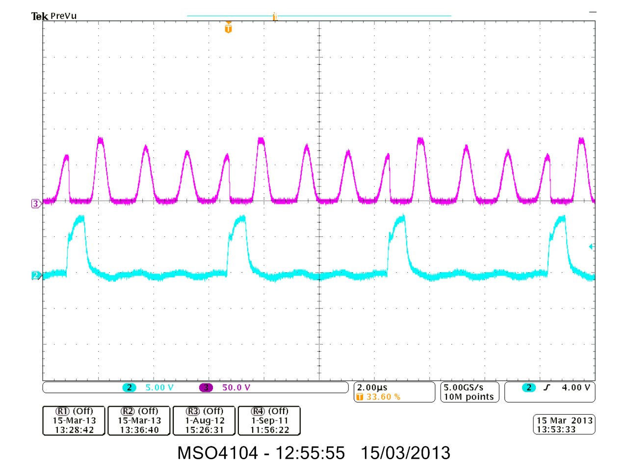

    I'm wondering if the inductor's stray capacitance is the cause of a ringing I'm seeing on the switch node (the junction of the FET, indcutor and diode). When the FET switches off, I see the expected voltage boost from the inductor, this then returns to zero, but then I see similar pulses bit later on. Image attached below (FET gate in cyan, switching node in magenta).
    Is there a rule of thumb with regards to inductor calue and stray capacitance; something like, large inductance, more windings, more capacitance??

    Yep your coil resonates at 680kHz , probably reasonable for the inductance value used.
    But your coil must resonate somewhere, so the "ringing" will never go away.
    It's an entirely normal kind of waveform for a boost converter running DCM at very light load. You will get a nicer looking waveform when it loads up.
    If you could reduce the capacitance, then you would just get more ringing cycles, which just heats up the core.
    If your system always runs at the same power level , then you can tweak the frequency so it switches on when the source waveform is close to ground and get ZVS to lower losses.
    I wouldn't normally tag your waveform as "ringing" it's just the coil flopping around and harmless. But you can get parasitic ringing when the MOSFET switches off , however your snubbers and slewrate control have eliminated this . This parasitic ringing can be a problem as it is a much higher frequency, generally radiates EMI, and can overvolt the MOSFET and rectifiers. You might see some of this parasitic ringing if the booster transitions to CCM at full load. The cause is usually charge storage in a rectifier diode changing to Schottky or  "soft recovery" diodes helps too.
    If you find you are a long way from CCM at full load , then you might consider a smaller inductor.

    For my application, the converter is well into DCM even at full load. (I was a bit over enthusastic when stating the load at 100mA, it is more like 10mA). I did have a try at tuning the switching freq to align the FET turn on with a period when the switching node is at 0V, I need to play with this some more. It's a bit of a juggle because the duty cycle obviously changes with frequency!
    I'm also going to try an alterantive FET with a lower gate charge. IRFS4260 rather than IRFS4229.
