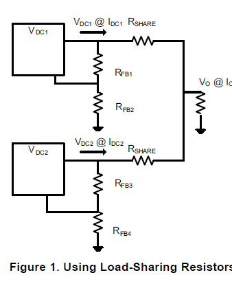

Every LDO would have its own internal reference.
The one with the higher reference will dominate all the load current.
VFB is 1.225V typical, if one has 1.225V and the other 1.224V, the 1.225V will dominate the load current.
The 1.224V will only start providing current when the 1.225V hits current limit.
They will NOT share current naturally.
You can insert a BALLAST resistor per this app note, to force sharing.
Ballast Resistors Allow Load Sharing Between Two Paralleled DC/DC Converters
http://www.ti.com/lit/an/slva250/slva250.pdf
This is DROOP sharing, as the name implies the voltage at the load will drop (droop) as the load current increases.
This deviation must be figured in using the app note details.
To increase load current it is really best to put a higher current LDO in vs trying to parallel 2 of them.
