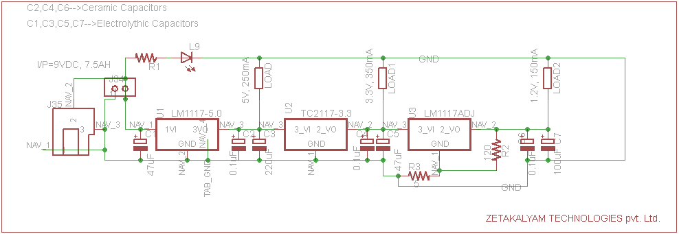

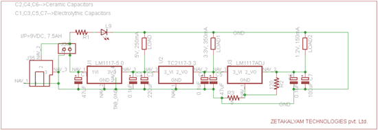

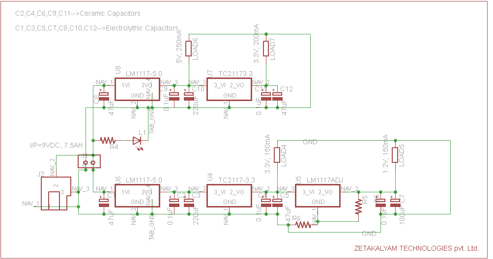

HI,
We are using 1.2V,3.3V and 5V and the load consumes 750mA current with the input DC at 7.5V,7AH battery / 9v, 1A from adapter. We are using LM1117(800mA) regulators for this.But we have a problem in this design.We are facing a overload problem and also the regulators gets more heat.So please give me the suggestions to solve this problem .I have attached our power supply schematic diagram (two files,we are tried both the types).
Naveen
  • Naveen,
    The power lost in the 5V regulator(s) is (Vi-Vo) * IOUT = 3.0 watts.
    The power lost in the 3.3V regulator(s) is (Vi-Vo) * IOUT = 0.68 watts.
    The power lost in the 1.2V regulator is (Vi-Vo) * IOUT = 0.32 watts.
    The circuit board / heat sink needs to absorb heat from regulators and pass that heat to the environment.
    Better heat sinking or changing the design to switching regulators will lower the device temperature.
  • Hi Ron Michallick,
    Thanks for your valuable inputs, Appreciate your suggestion.  Suggest me the required regulators(either linear or switching type). Previously, I mentioned our requirement as shown in schematic diagram. We are using 7.5V,7AH battery or 9V,1A adapter alternatively as a input.We need 5V,3.3V,1.2V output voltage for a 800mA to a max of 1000mA load. So please suggest me which type of regulator is better for our application with their part number to solve the problem. Then we can replace our old design.
    Naveen
  • Naveen,
    The Webench designer availible on the www.ti.com web site home page (and under power management section) is a powerful tool to select switching regulators complete with recommended circuit components. It gives many choices of various BOM cost and power efficiencies.
    Just enter min/max VIN, VOUT, IOUT and TA temperature then click start design. After a minute solutions will be shown.
