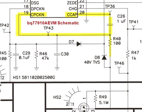

I found a discrepancy between the bq77910a part data sheet and the bq77910AEVM evaluation module schematic for the CPCKN and CCAP pins.

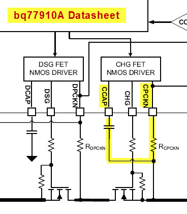

The bq77910A data sheet (SLUSAV6-FEBRUARY 2012) on page 33 shows a series connection of a capacitor and a resistor between the CPCKN and CCAP pins.
The bq77910AEVM User's Guide (SLUU855-February 2012) on page 30 shows a capacitor connected between CPCKN and CCAP with no series resistor.
Which connection is correct and why?

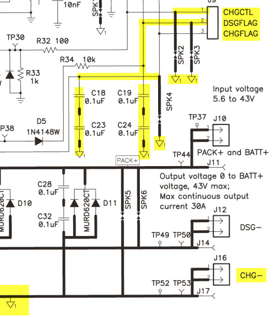

Also, referring to the bq77910AEVM schematic on page 30, what is the purpose to C18, C19, C23 and C24.  Why are they both tied to CHG- return.  Would it be better to connect the DSGFLAG bypass capacitors to DSG- instead of to CHG-?  The spark gaps are also all connected to CHG- ground.  What is the the reason for the ground selection.
  • I have updated my original post with images showing the discrepancy between the bq77910A datasheet and the Evaluation module schematic.  This should make it easier to see the discrepancy between the two.
    Does anyone have an idea as to which of these two configurations is the correct one?

  • Regarding the CCAP capacitor placement: The device regulates CCAP with respect to CPCKN, so the capacitor connected at the CPCKN terminal is best for the regulator.  It also avoids transients pushing up CCAP.  This connection will have some effect when the part turns on the CHG output and the capacitor charges the gate of the FET.  See www.ti.com/lit/slua612 sections 6 & 7.  Either position can work, the EVM placement should be safer for the IC.
    The capacitors C18, C19, C23 and C24 are to provide ESD protection for the flag outputs.  The expectation with the EVM is that the user could short the power FETs and use the flag outputs as the board outputs.  The diodes were provided in the flag ouptuts so a user could not back drive the device outputs by trying to use both the flag outputs and FETs.  With the FETs shorted or without, CHG- is potentially the most negative voltage in the system. Since the DSG- also connects back to the sense resistor, it could have been used, but if the board was converted to series FETs, CHG- would be the output terminal.  So the CHG- terminal was used.
    Note that a highly configurable EVM like this one does not represent a finished product and the ESD design may need further development for use in a product.
