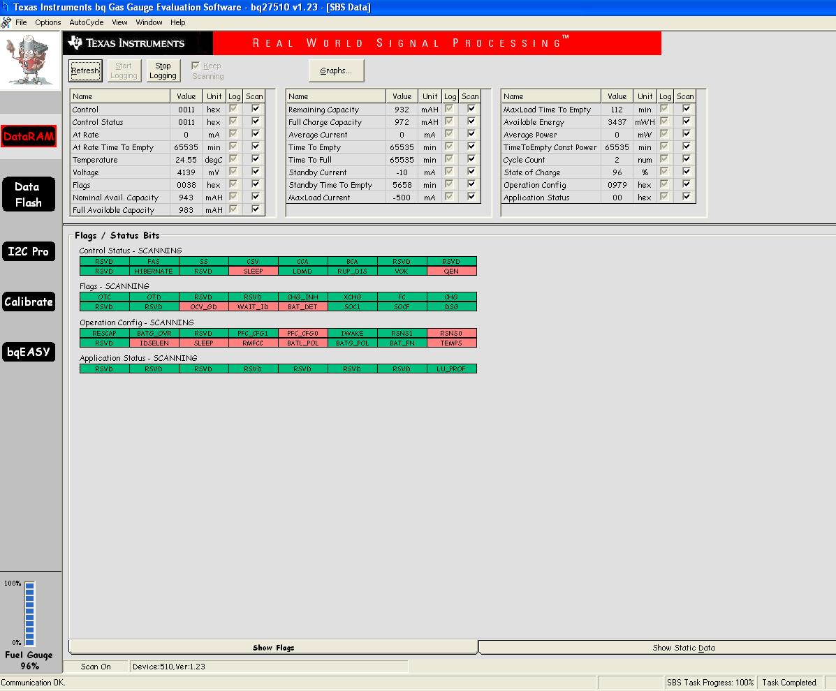

  • Dear Casey,
    Please find the details you have asked, I have attached the screenshot.
    We need to continue the Learning Cycle once again to get the details you have asked.
    Again the same problem happened. FC Bit is not Set.
    For Charging the battery in learning cycle 5A , we are manually charging the battery by connecting to a separate charger circuit.
    After the Battery is fully charged, we are connecting the Battery to the EVM module.
    Please guide us are we are in trouble.
