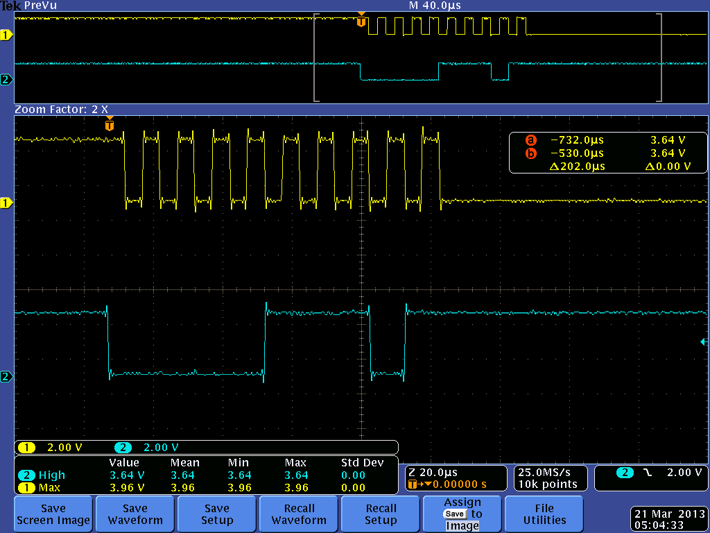

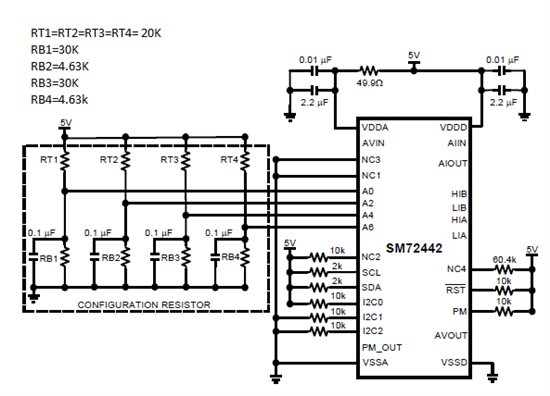

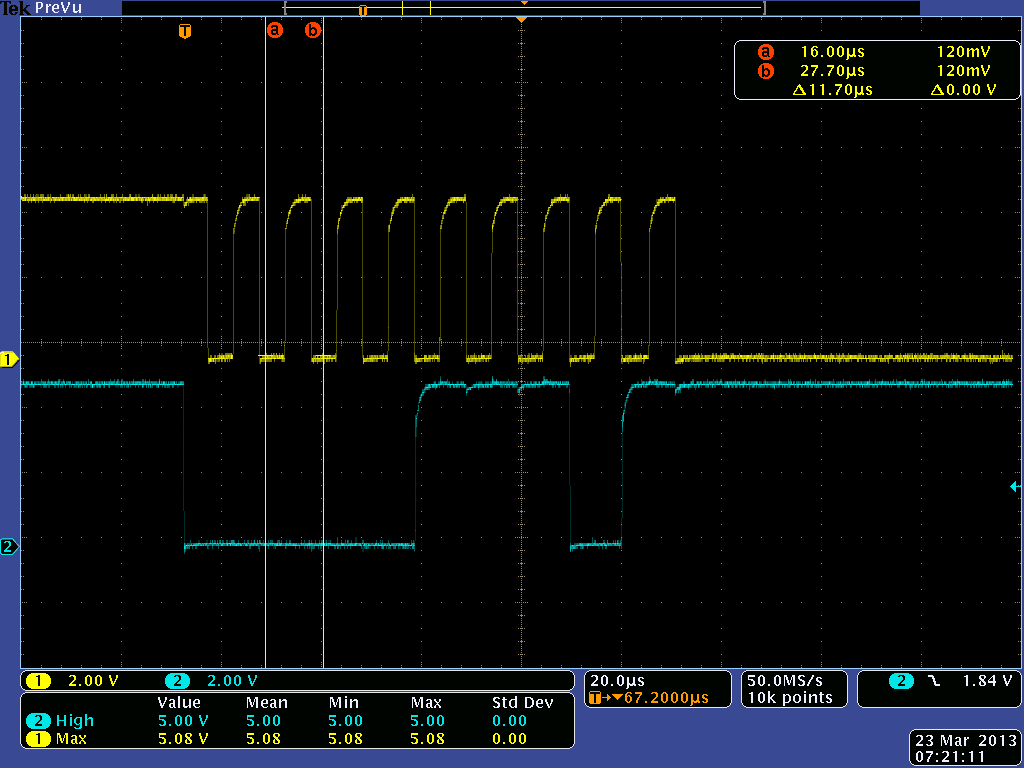

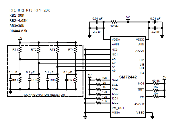

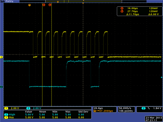

We are a senior design team working on the design of a MPPT charge controller. We are using the SM72442 and the MSP430G2553 launchPad to read out the values from the charge controller. When we run our i2c code we do not get an acknowledge bit from the SM72442. We are attaching the schematic of the configuration used only for communicating with the MSP430 via I2C.  In addition we have attached the screenshot from our oscilloscope displaying the clock (Yellow line) and data (Blue line) lines, but the SM72442 does not respond. we have reviewed the datasheet and carefully read page 13 for I2C communication. below is the link of the PDF for the SM72442.
http://www.ti.com/lit/ds/symlink/sm72442.pdf
Our address is: 0x07, and our I2C0=1; I2C1=1; I2C2=1
Please we do appreciate a prompt response, due that we are running out of time for the deadline of our project.

  • Can you post your real schematic (not the cut'n'paste from the datasheet)?
    Also from the ds:
    Noise coupling into digital lines greater than 400 mVp-p (typical hysteresis) and undershoot less than 500 mV GND, may prevent successful I2C communication with SM72442. I2C no acknowledge is the most common symptom, causing unnecessary traffic on the bus although the I2C maximum frequency of communication is rather low (400 kHz max), care still needs to be taken to ensure proper termination within a system with multiple parts on the bus and long printed board traces. Additional resistance can be added in series with the SDA and SCL lines to further help filter noise and ringing. Minimize noise coupling by keeping digital races out of switching power supply areas as well as ensuring that digital lines containing high speed data communications cross at right angles to the SDA and SCL lines.
  • I'm operating at 100KHz, a little bit of noise but still no response. I have been able to communicate with other I2C devices effectively but not with the "SM72442".  Is there anyway you could post the schematic of the most basic setup or configuration to communicate with the SM72442?

    It appears that the issue might be something else, perhaps with the way the IC is interfaced, or perhaps with the firmware used to talk to the device.  Have you tried toggling the ~RST line low for 300us before talking to the device?  It would help us to see the low-level I2C code you used to interface to this chip.  The way the I2C bus behaves is similar to the framing requirements of SMBUS.  If everything is setup correctly, you should be receiving an ACK.  By default the schematic in the datasheet that you copied has the 7-bit address as 0x01.
