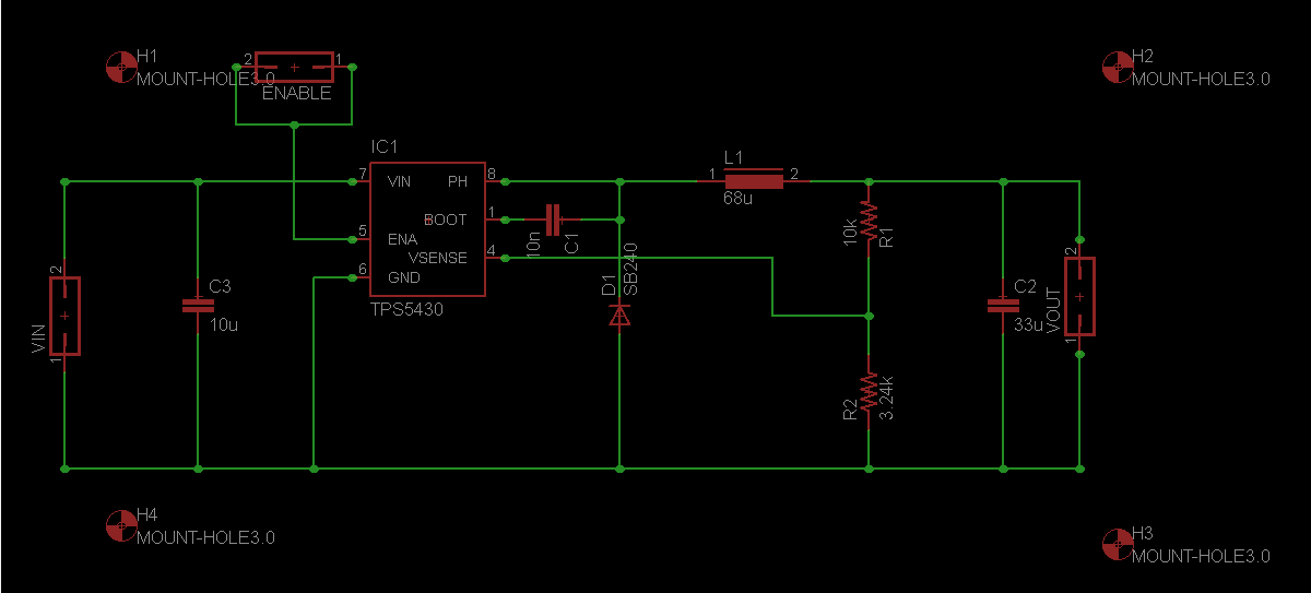

To whom it may concern,
I am using a TPS5430 for a 5V supply to another chip and I'm having some issues. My supply is 32V and the chip has no problem regulating 5V unloaded. When I put the expected load on the output (600mA) the chip shuts down after a couple of seconds. I have a reinforced ground plane on my pcb on top an bottom with vias under the chip so the thermal pad can connect to it but it wont regulate under load.
Why are these chips rated for 3A but shut off after 600mA. If anyone has any ideas on how to heat sink it better let me know because I've run out of ideas.
