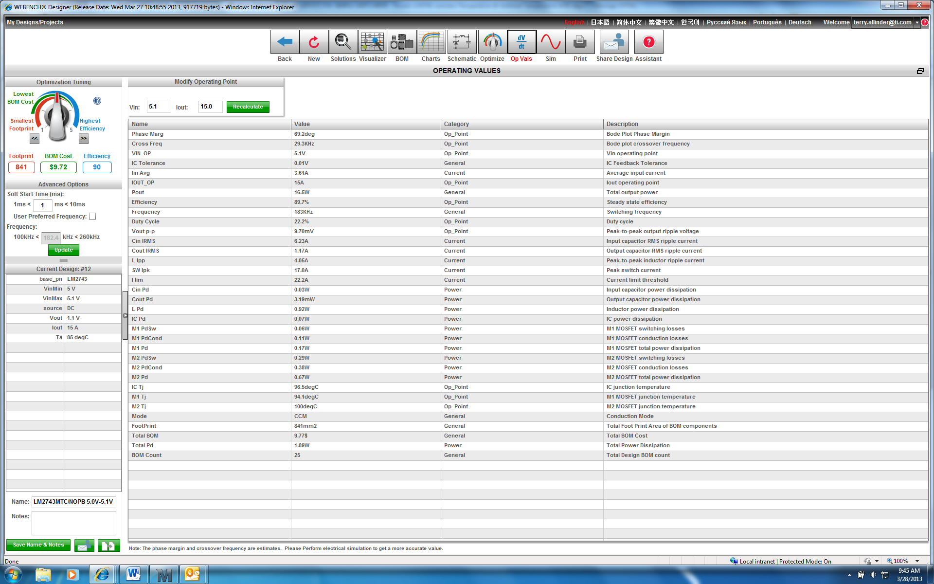

Hi folks,
I am using LM2743 in one of the power supply applications, I want to know the junction temperature of the IC at ambient temperature of 85 deg C. After simulating using WEBENCH it show the junction temperature(Tj) to be 45 deg C at the ambient temperature of 30 deg C. Since WEBECH is not allowing to change the ambient temperature to 85 deg C. I tried to calculate using the data given in datasheet, but its coming around 2000 deg C which looks incorrect in any case. I am using the following formula for calculation:
TJ = TA + (RΘJA * PD)
But it looks RΘJA specifications are not clearly given in the datasheet. I took it as 155 deg C/W.
My input is 5.0V and output is 1.1V @ 15 Amperes.
Thanks in advance for your support.
Thanks and Regards
-Anand Kr. Rai
  • Anand,
    The  RΘJA is the thermal resistance from junction to ambient.  When you mount the LM2743 to a PWB what you need to know is the  RΘJB, the thermal resistance from the junction to the PWB, this is normally much lower than  RΘJA.
    I went into WEBENCH and I was able to change the Ta to 85C, I'm not usre why you were not.  I have attached the secreen shot Tj is 96.5C
    Terry
  • Hi Terry,
    Thank you very much for your quick support. This is for what I love TI.
    Actually I selected LM2743 from the list of solutions when I entered my input and output requirements in WEBENCH, and I got the schematic to be used, I was expecting that I can the temperature only if there is Thermal Analysis option available with the chip. But I did not know where is that option.
    Anyways my problem is solved. Thank you.
