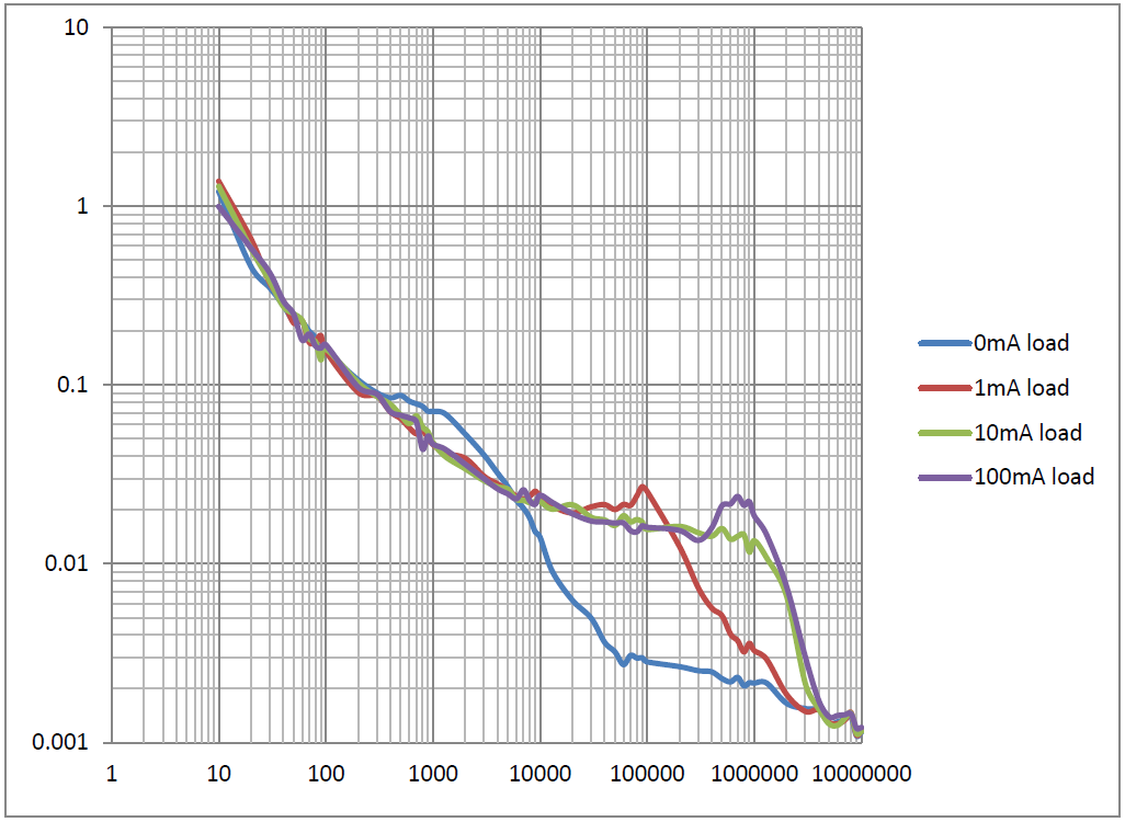

Looks like a nice part. The X-Axis on figure 13 seems to be incorrect as the interval between the major vertical gridlines would usually follow the powers of ten. (i.e. 1,10,100, 1000 etc.)
Not sure what happened to this image, but somehow it got past QA.
I will submit a request to get it corrected, but that will take several days.
The final image for LP5907 Noise Density, Figure 13, should look like below ...
(X-axis is "Hz", Y-axis is "uV / root Hz", same units as the image in the datasheet.)
