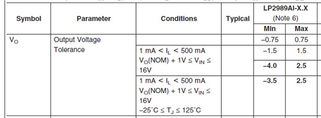

Look for a high precise LDO in full temperature range. We find the LP2989 is 0.75% output voltage accuracy.
Please find the datasheet page5.
Do this mean this device could  get 0.75 % output voltage accuracy only in 25degree?
In the full temperature, is the accuracy -3.5%-2.5%?
