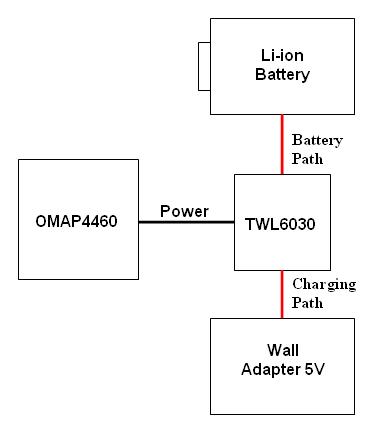

We are facing some issues with Battery charging in custom board based on OMAP4460. We have used TWL6030 as a power managment IC for OMAP4460. We are using inbuilt battery charger on the PMIC. Battery charging problem is described below,
We have Android ICS platform on the custom board. When board is turned off using POWEROFF icon in adroid menu i.e. when TWL6030 is in WAIT-ON/OFF state, we are observing that battery charger path will cut off and battery will stop charging even though charger is connected. We want to have system that will continue charging even though board is shutdown provided battery and wall adapter are present.
Please anyone suggest a method to keep battery charging even when TWL6030 goes to WAIT-ON/OFF state.
