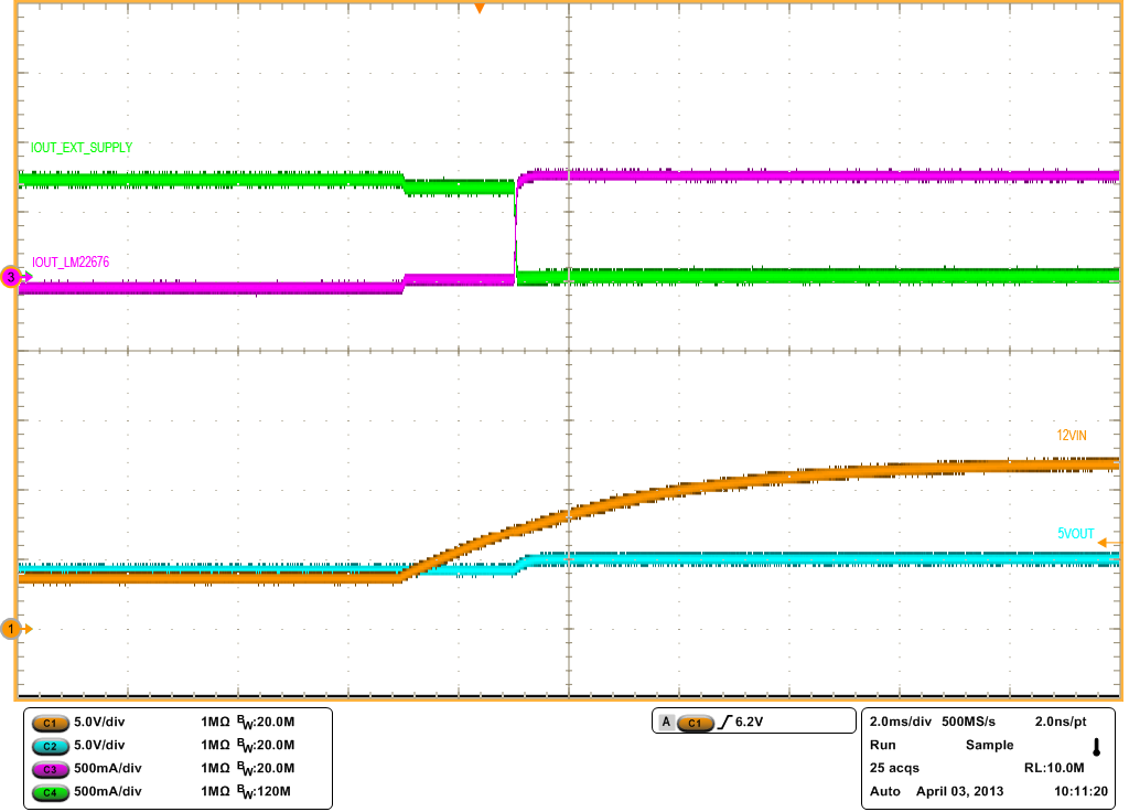

    I happened to have an evaluation board in the lab, here is a startup test with a 12V supply and a 5V (-diode drop) prebias on the output:
    CH1 is the input of the switcher, initially showing the prebias voltage from VOUT and then ramping up to 12V.
    CH2 is the output of the switcher, initially showing the 5V external bias - diode drop and then ramping up to 5V when the switcher kicks in.
    CH3 is the output current coming from the switcher.
    CH4 is the current coming from the external 5V supply.
    Note that the output of the switcher should be configured to be slightly greater than the USB voltage minus the blocking diode drop, so that the switcher takes over once the switcher is ON and USB is still connected.
