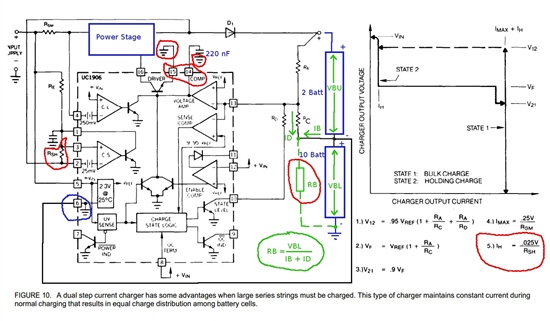

I'm designing a charger for a string of 12 (twelve) car batteries connected in series.
I'm using the bq24450 in Dual Step Current Charger mode.
- The maximum charging current (Imax) of the batteries is 10 Amps. (Battery capacity = 110 AH)
- The input voltage (Vin) is 170 Volts DC maximum(unfortunately, this value can not be lowered because it comes from a generator)
- The minimum expected Voltage for all batteries in series (assuming each battery is discharged to 10.8 Volts) is 130 Volts (12 Volts x 10.8V = 129.6)
-Then, the maximum voltage through the Power FETs  will be 40 Volts.
- In order not exceed  the bq24450 supply operating voltage , the ground pin is connected to a tap point in the high side of the tap (second battery in the string, i.e, a  maximum approximate Voltage = 27.6 Volts ).
- The pass transistors are two power FET channel-P, p / n: IXTH90P10P.
 I put some questions and doubts in the text below.
 - Then, I assume  that the Voltage Trip will be the voltage sum of the two high side batteries:  (13.8V + 13.8V = 27.6 Volts) (used as power supply of the bq24450),
 Is it Correct?

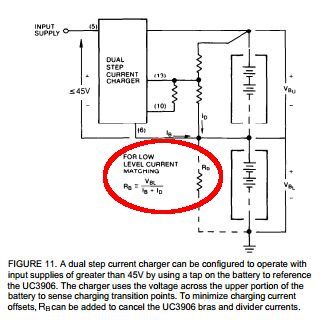

- The figure below (Fig-11 & Fig-10) shows a resistor RB connected in parallel to minimize the charging current offset:
-I'm confused about the calculation of this resistance RB;
- (IB) & (ID)  currents:  (IB) is bq24450 Operating  Current? (approx. 2 mA)?;
- (VBL) voltage: should I consider for calculating, the value of (VBL) when batteries are at 10.8 volts (discharged)? (i.e.: 10.8 V/batt x 10 batt. = 108 Volts)?
- Regarding  Reference to Ground (circulated in red color)  in Fig-10 (bellow):
- (1) I assume that, with a string of batteries, the ground reference for those points (derived from pins 14 and 15), is the same as pin 6. Is this correct?
Thanks in advance.
Regards.

  • For the multicell application above, it look like pin 6 should be tied to the top of the 10 cells as per your first figure.
    What is your question on the 3 cell dual current charger.

    These are my questions regarding 3 batteries in series about components  calculations:
    NOTE 1: I use two batteries in serial (of the 3 batteries) as Input operating voltage for  bq24450.
    NOTE 2: (The Fig- 10 & 11  mentioned below,  are the same; only change the number of series connected batteries).
    Then:
    (1) I assume  that the Voltage Trip will be the voltage sum of the two high side batteries:  (13.8V + 13.8V = 27.6 Volts) (used as power supply of the bq24450),
          Is it Correct?
    (2) The figure below (Fig-11 & Fig-10) shows a resistor RB connected in parallel to minimize the charging current offset:
    (3)  (IB) & (ID)  currents:
           (IB) is bq24450 Operating  Current? (approx. 2 mA)?.
    (4) (VBL) voltage:
          Should I consider for calculating, the value of (VBL) when batteries are at 10.8 volts (discharged)? (i.e.: 10.8 V/batt x 1 batt. =10.8 Volts)?
    (5)  Regarding  Reference to Ground (circulated in red color)  in Fig-10:
          The ground reference for the components connected to pins 14 and 15 ,
          Is the same as the pin 6?.  Is it correct?
    Thanks.
  • Charles,
    (1) The figure  (Fig-11 & Fig-10) that I posted shows a resistor RB connected in parallel to minimize the charging current offset:
    Thanks.
