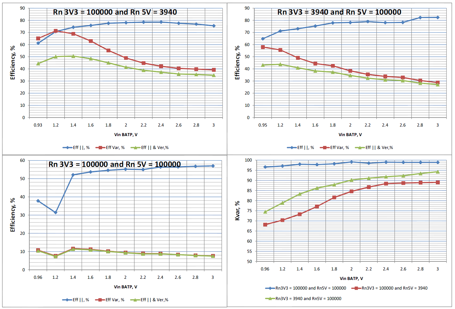

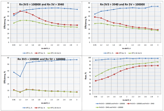

I changed input voltage (net Vin BATP) and I measured voltages and current consumption of my portable device with two working DC-DC.
I cann't reach efficiency values from TPS61028 datasheet.

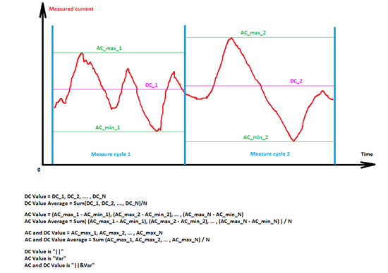

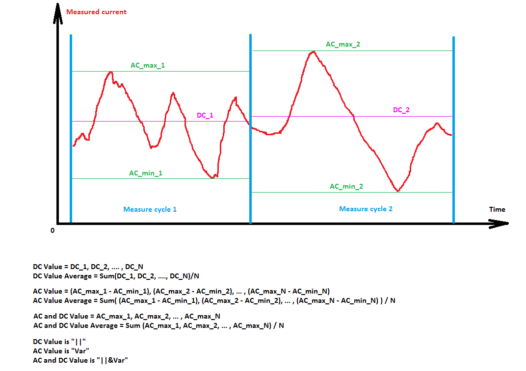

I used multimeter Agilent U1252B for current consumption measurement on net VinBATP net and Agilent DSO-X 2012A oscilloscope for average (average time is 10 ms) voltage measurement.
Multimeter can measure current in three modes: AC, DC and AC+DC. I attached picture for understanding difference between modes:
I measured current consumption in all three modes and in case without load, with resistor load 3940 Ohm on 3,3V net and with resistor load 3940 Ohm on 5V net.
I attached results of my measurements:
0602.PE_BRPD_Debug.pdf
The graphs of efficiency is below:
I have a few questions:
1. Why current consumption of TPS61028 without any load (I measured about 100000 Ohm) is more than 2*45uA = 90 uA (I used two DC-DC)?
2. What kind of current consumption value is used, when measured efficiency in TPS61028 datasheet? (DC value or AC+DC value, or AC value)
3. Why efficiency of TPS61028 is low (about 15% less)?
Input and output capacitors I placed near IC without vias and so on. I placed inductor (10uH) on bottom side of PCB and connected with IC by means of two parallel vias.
4. May I increase efficiency if I will use TPS with fixed output voltage instead adjust version?

    I added electrolytic (tantal, Low ESR) capacitor 100uF on input. Measured current consumption values in DC mode is not changed, but values measured in AC mode and AC DC mode were decreased in 4-5 and 2-3 times.
    Conclusions:
    1. I have not answer on question #1.
    2. I have answer on question #2: " DC value of current consumption is used in efficiency measurement.
    3. I added addition capacitor after ampermeter for AC component exclude. I have not difference (in most cases it was absolutely equal) between values, measured in DC mode and DC mode with additional capacitor. But I am understand, that right measurement with additional capacitor.

    I read slyt412.pdf and understood difference between Iq and no-load current consumption. I cann't find any information about TPS61028 no-load current consumption (equivalent Fig. 4 in slyt412). I want to know about measured current consumption values (column "II, mA" for Rn 3V3 =100000 and Rn 5V = 100000 in file 0602_PE_BRPD_Debug.pdf). It's about 1mA and less.
    Why new device and old device give the same efficiencies? Graphs from they datasheet is not equal.
    I have not answer on question: "If using TPS with fixed output voltage is more efficient instead adjust version?"
