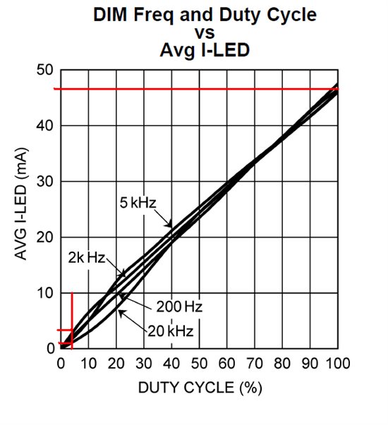

  • Hi yusuke,

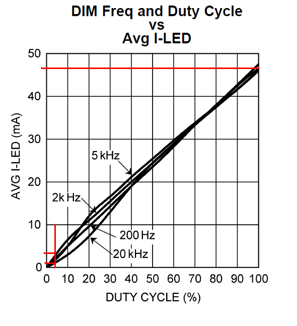

    You could refer to the  datasheet of the LM3410 figure 7 (DIM Freq and Duty Cycle vs Avg I-LED) and estimate what dimming ratio you could obtain at different PWM frequencies. Concerning LM3530 I couldn't advice you anything except that  datasheet mention 1000:1 Dimming Ratio.

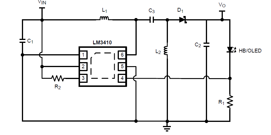

    While LM3410 could be used for SEPIC topology and thus could drive as well only  one LED. Look to the LM3410XSDSEPEV (LM3410XSD SEPIC High Brightness LED Evaluation Board) as reference

    For the LM3410 the boost does have a min duty cycle of 2%.  I figure this is to provide a method for monitoring the switch current.  So what could possibly happen is that the min VOUT will always have to be higher than VIN which means that at small VIN to VOUT ratios the regulation loop around the RSET resistor will not work very well.  You end up regulating to a min duty cycle rather than the feedback voltage.
    We also suspect that the LM3410 does not get to 1000:1 dimming ratio.

    The LM3410 could drive the 1 LED and handle the current, but we suspect that it cannot reach the 1000:1 dimming ratio.

    Please refer to the "AN-1775 LM3410X SEPIC 6-Pin LLP Demo Board" to drive 1 single LED. schematic is below
    Concerning  possible Dimming ratio for LM3410 see figure below from datasheet.  According to this picture and taking into account minimal DutyCycle 2% with LM3410 roughly possible to obtain Dimming ratio about 100:1, higher ratio it  could be the issue. Could you share for what kind of application you need ratio 1000:1 or 3000:1.
