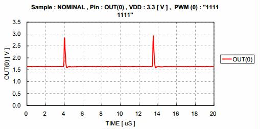

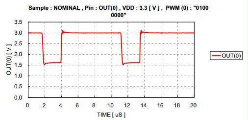

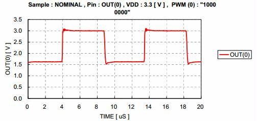

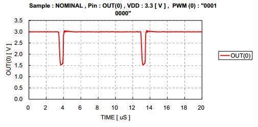

    Thank you for the clarification.  The PWM0-PWM15 registers set the ON duty cycle when enabled through registers LEDOUT0-3 (14h - 17h).  Since the registers set the duty cycle, this sets the percentage on and off.  When on, the brightness will be set by the LED current.  The brightness will appear to change as the on / off timing ratio changes.  It is not changing the brightness of the LED, only how the eye reacts to the high frequency on / off (with duty cycle set through the PWM0-15 registers).
    It will appear to be a linear change in brightness.  I have attached some examples of what the output will do based on the PWM register.  The plots show the ON time (output low) based on the PWM register.  The plots show PWM0 register for values of 10h, 40h, 80h and FFh.
