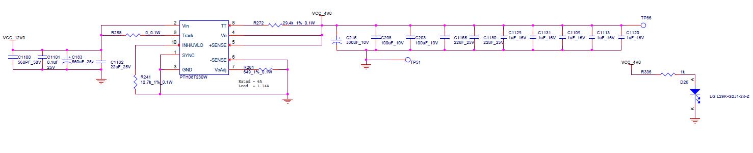

We are using PTH08T230WAD for 4.0V generation. The module was working fine for 3 weeks. After that the module is not starting up.
When we probed the Inductor point and Mosfet gate signal in the module, found no switching happing. When the power is first applied, the module is not giving any PWM. It is always low.
We removed the INH/UVLO resistor and still the module is not starting up.

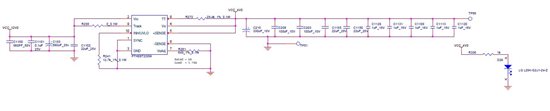

I have atatched the schematics for reference. Please clarify why the module is not starting up.
