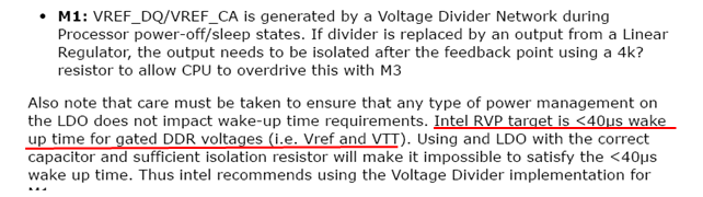

I hope to know whether TPS51206 is spec in Intel RVP wake-up time(<40us) or not.
refer to the below image.
And if you know, What is the wake-up time among below 1,2,3?
