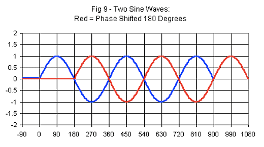

The POL works good individually, but output currents show 180 degree out of phase(like two sine waves are 180 degree out of phase)  during parallel operation.(run two POLs together)
However this problem is gone if an external clock is being used to the sync pins for synchronization.

  • Hi John,
    I put a similar picture instead of the schematic as below since I am replying from my home.
    The reason which I have to add parallel function is a standard product design under small PWB size. So users can decide to use one POL or two POLs for high power.
    I may have to add the condition of sync pin usual for parallel operation  in datasheet, but I want to know why we have to use sync pin of the IC for parallel operation.
    Otherwise the output currents shows as below. Thanks.
