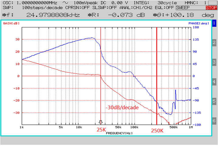

For a stable system, the slope should be -20db/decade at the gain crossover 0db.
The slope is about -30db/decade at the gain crossover 0db. Is it a concern for stability? please see below
