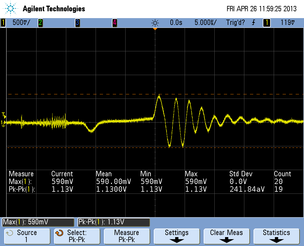

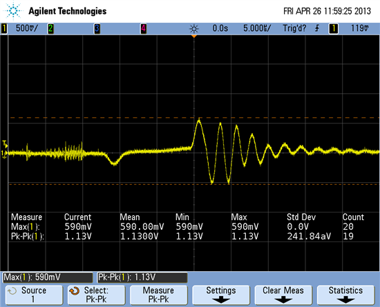

After few days we are again powered on and measured the output as 0.3V at negative output. But the +15V output section was working fine. Then the switching waveforms are probed and noted that switching was not done. The switching frequency waveform taken at power on was attached with this mail.

    And also I have probed the output signal waveform, switching waveform, feedback signal voltage and VREF signals at power on.
    The negative  (-15V) was goes to -8V and rose to +12V then damped and settled at  0.3V. The same thing was observed at switching frequency output also.
    The VREF signal was not settled at 1.2V . This also oscillated with 10V(peak to peak) and settled at 0V.
    The feedback voltage was raised to 8V and slowly decays and reaches zero within 40uS.
    I have attached all the waveforms, layout and schematic here for your reference.

  • The RC time constant (delay) for enable should be less than 10uS. But, the circuit has a 100 ohms R and a 0.1uF, two 4.7uF 'C' values. The achieved delay is 950uS.
    This delays the gate control of both Boost-converter & Boost-inverter circuit. Since the Boost-converter gate control has an effect of feedback voltage only, whereas boost-inverter gate control has an effect of Input voltage.(As referred from internal block diagram of IC).
    After removing the additional two no.of 4.7uF capacitors in parallel with 0.1uF in VIN pin, the -15V was settled at correctly.
