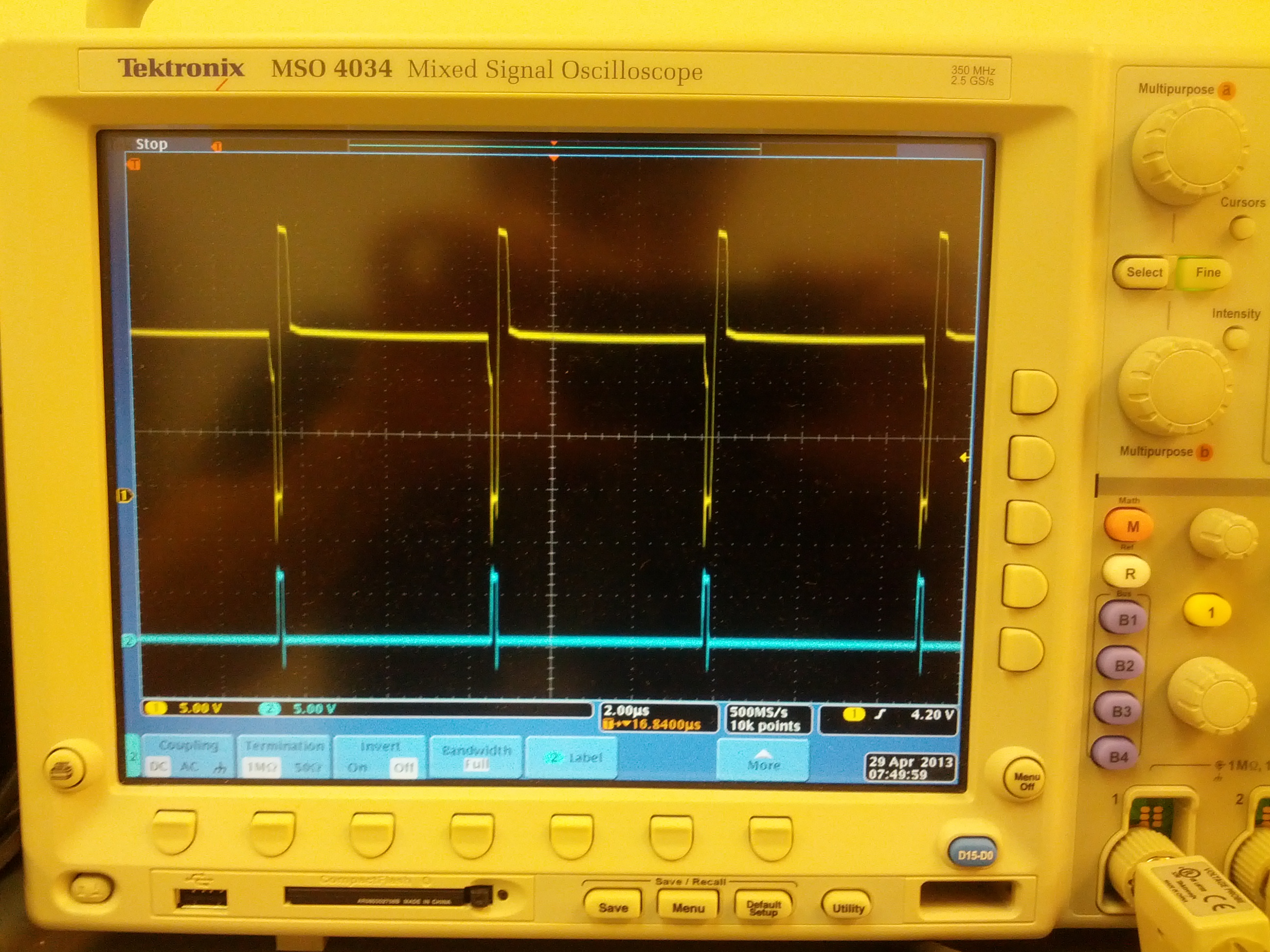

So I just built a test board with the BQ24650, and some other IC's...stuff. I am using a 4-cell LiPO4 battery(6AHr). THough it states I am charging (STAT1 = ON, STAT2 = OFF), it's not charging correctly...if at all. I am getting odd shapes for my waveforms on BTST/PH/DRVH combination of signals. Attached picture is the BEST I can make it look. What is odd is that this picture occurs at Vsolar @ 24V. If I drop Vsolar to say 20V, I get large oscillations on the BTST/PH/DRVH signals.

Please take a look at the picture and let me know if this is expected. As a remind...this is the BEST  Ican get it...when I cool down Vsolar to 20 or less, I have huge ringing during high/low transitions =/ does the boost dioe do this? that's my guess...

  • Can you please comment on the picture I provided? This is a pic of DRVH and DRVL. Looks like I have a very violent transient on DRVH...not sure where it is coming from.

  • Assume the top signal is the switch node and the bottom signal is the low side drive?
    Can't get much information from this.
    Can you lift the inductor and connect with a loop and get ainductor current waveform?
    Still would try and compare this with an EVM.
