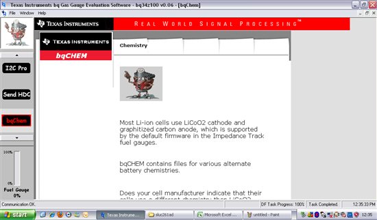

Hi there,
I've looked at other posts about this, but my problem appears to be slightly different. Within the bq34z100 evalution software, the bqChem tab tells me it cannot find the bqCHEM.ini file, despite that fact that this is present within the 'plugins' folder in the program files, however, I'm led to believe this isn't a huge problem, and it can still work without this file. My main problem is that the software simply will not display the chemistry list, and so I cannot select a chemistry, and it can't be programmed to the chip.
I have used the Gas Gauge chemistry updater tool here http://www.ti.com/tool/gasgaugechem-sw to update the battery chemistry files. I even deleted the Chemistry sub-folder (within 'plugins') beforehand, as was suggested in a different post. However, despite all of this, the bqChem tab in the evaluation software will not show the list of chemistries at all. It only shows a seemingly default screen explaining why different battery chemistries make a difference.
I have tried re-installing both the evaluation software and the chemistry updater several times. I've also restarted my computer. I can see from the excel spreadsheets within the chemistry updater tool which chemistry I need to program - is there a way to do this manually by changing certain flash data parameters?

    We found a problem with the bqEVSW where it would lose the chemistry data. We placed an updated setup program on the bq34z100 website a couple of weeks ago. Did you download this updated version? What operating system are you using? You will need to select the administrator option, if you are using Windows 7. When the program gets to the screen where it ask if you want to open bqEVSW, then uncheck all of the boxes and continue.
    Tom

  • Hi Tom,
    I've installed Mathcad 14, and unfortunately the evaluation software still won't display the values, although, as mentioned before, it no longer has any difficulty with the .ini file. I tried re-installing the evaluation software after Mathcad was installed, and re-updating the chemistry files, both using the most up-to-date files on the website you directed me to, but to no avail. Is there anything else you can suggest? I'm using Windows XP.
    Many thanks,
    Heather
  • Heather,
    Does the program show any of the ChemID's and has it ever worked for you? What operating system are you using? If you are using Windows 7, then you need to use the Administrator option when loading the tools. Have you tired deleting all of the files from the Chemistry directory to see if that will resync the files?
    Tom
  • Hi Tom,
    I'm using Windows XP. I've included a screenshot as to how the software looks within the bqChem tab. It may also be worth noting there's no scroll-bar available within that screen.
    It has never worked yet unfortunately. I have tried deleting all the chemistry directory files and re-synching, but it doesn't make any difference I'm afraid.
    Cheers,
    Heather
  • Heather,
    I have not been able to reproduce your problem, but we are looking at it.
    Tom

  • Heather,
    Here is the default senc file with ChemID 404 installed. You will need to manually enter your data flash updates, since I did not have a gg file containing them.
    Tom
    bq34z100_R0_V0_06_ChemID_404.senc
  • Hi Tom,
    Thanks for this, very helpful; I've programmed the file and the correct battery ID is now in place.
    I'm very grateful for all your help.
    Cheers,
    Heather
