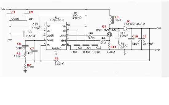

The circuit takes a 24 volt input and bumps it up to a nominal 48 volts. The designed output current using SwitcherPro Desktop is 4.2 amps. The schematic is inserted below as an image. However, when the output is connected to a test load, the switching stops. If the load is gradually ramped down, I can draw at most about 2.1 amps before it goes into overcurrent mode. Typically, it stops switching at about 1.4 amps.
The voltage on the Isens pin reaches a maximum of 40 mV, at which point it stops switching. During the overcurrent situation, the voltage on this pin falls to roughly 1 mV and stays there until retry. I attempted to short this pin to ground in order to see if I could draw more current. While shorted to ground, the controller stopped switching at less than 0.8 amps.
While there is no load, the FB pin is at 701 mV. As I apply a load, this voltage increases until reaching a maximum of about 737 mV when the controller stops switching.
These values were measured with a Keithley 197A DMM. The voltage on the Isens pin as measured by a scope is very noisy. I increased the capacitance from 180 pF to 1000 pF, which reduced some of the noise on the signal but did not improve the situation.
Any help would be greatly appreciated.

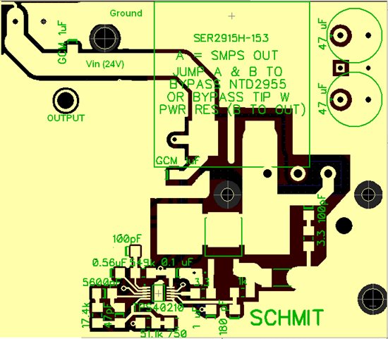

  • Hi Anthony,

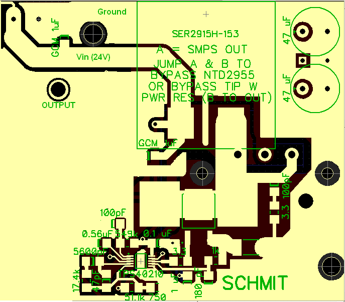

    Yes, this was built on a new PCB. What is the preferred method of sharing the layout? I will post an image of the applicable piece of the board here. The rest of the board consists of low speed analog devices and the testing was performed with these components isolated from the TPS40210 circuit. The switching MOSFET is FDD10AN06A0. This is a 60V 50A N-Channel MOSFET, Rdson = 0.0094 Ohms and a max gate charge of 28nC. (I think the original circuit schematic has a different but similar MOSFET pictured)
    This is only the top layer (2 layer board) and the diode is on the reverse side with a large heat sink. All of the surface mount resistors/capacitors (with the exception of the current sense resistor) are 1206 case size. There is a grounded copper pour around the components. I have removed analog components that were unrelated to this circuit so the pour looks larger than it is in reality. However, this will hopefully give you a sense of how things are laid out. I tried to observe the tips that were in the data sheet regarding placement, but it wasn't always possible.
  • Thanks Thomas, this works. Nothing jumps out at me from the layout.
    A few ideas, can try adding some ceramics in parallel with the 47uF capacitors on the output? What is the part number for the 47uF caps?
    Could you also some screenshots including the switching node, output voltage and gate drive voltage before entering hiccup current protection? Please use a timescale which is small enough to observe individual switching pulses. It might also be useful to catch it right when hiccup is tripped by triggering with VOUT falling.
    Lastly, can you try reducing R11 to maybe 5mΩ? Shorting out this resistor is not a good test because current information it senses is needed for the internal control circuitry in CCM.

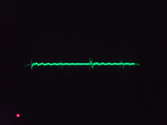

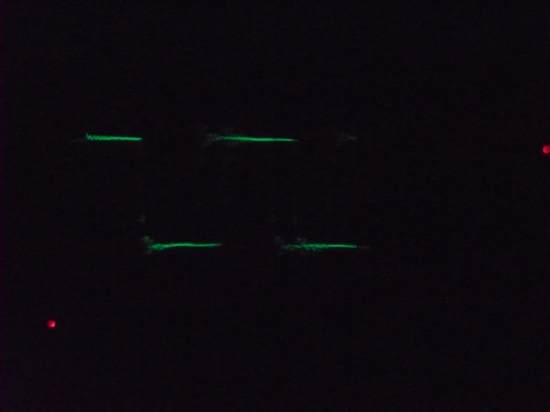

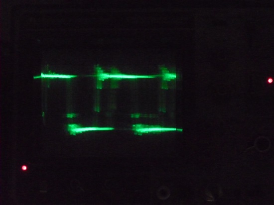

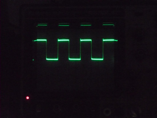

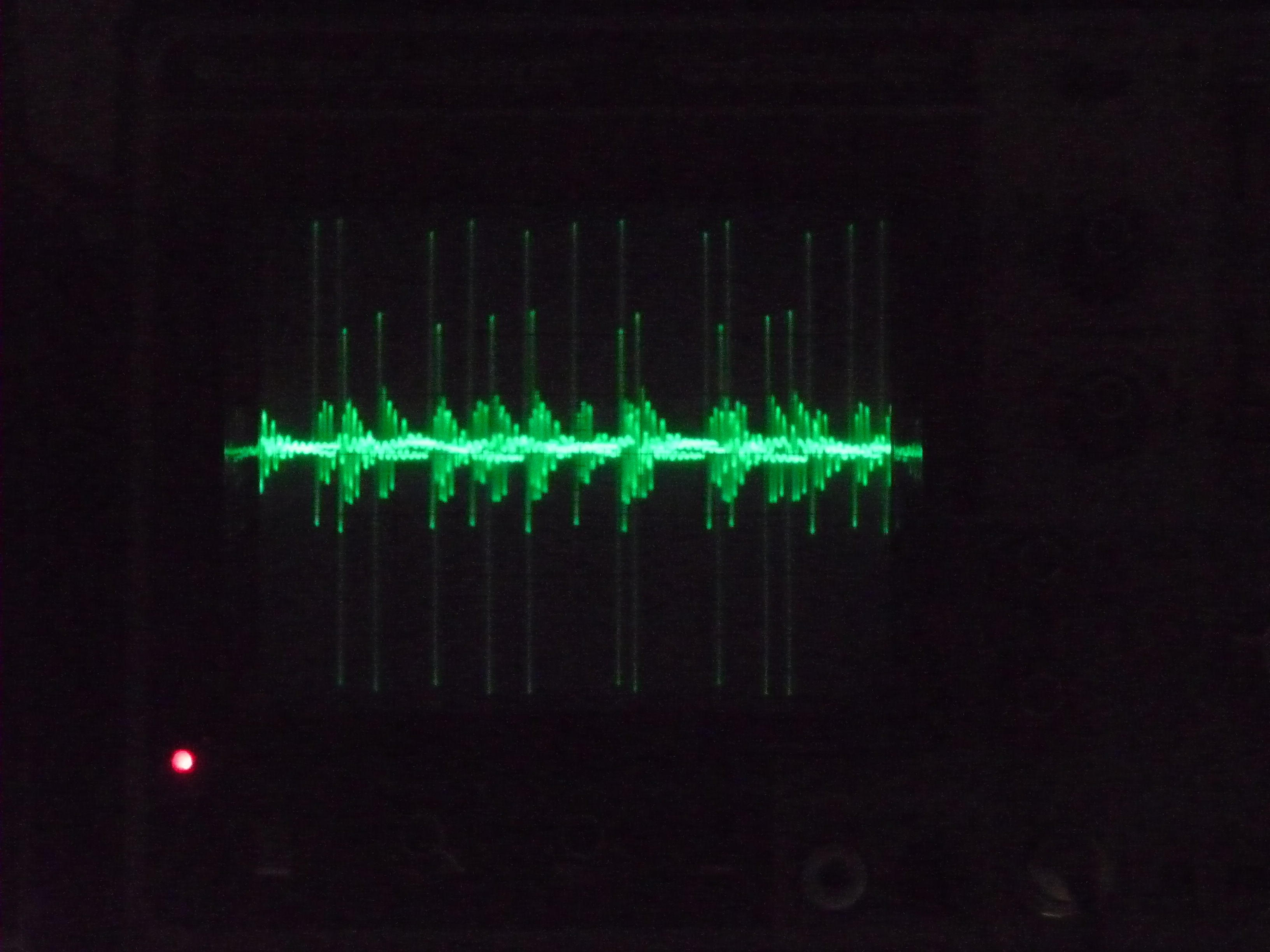

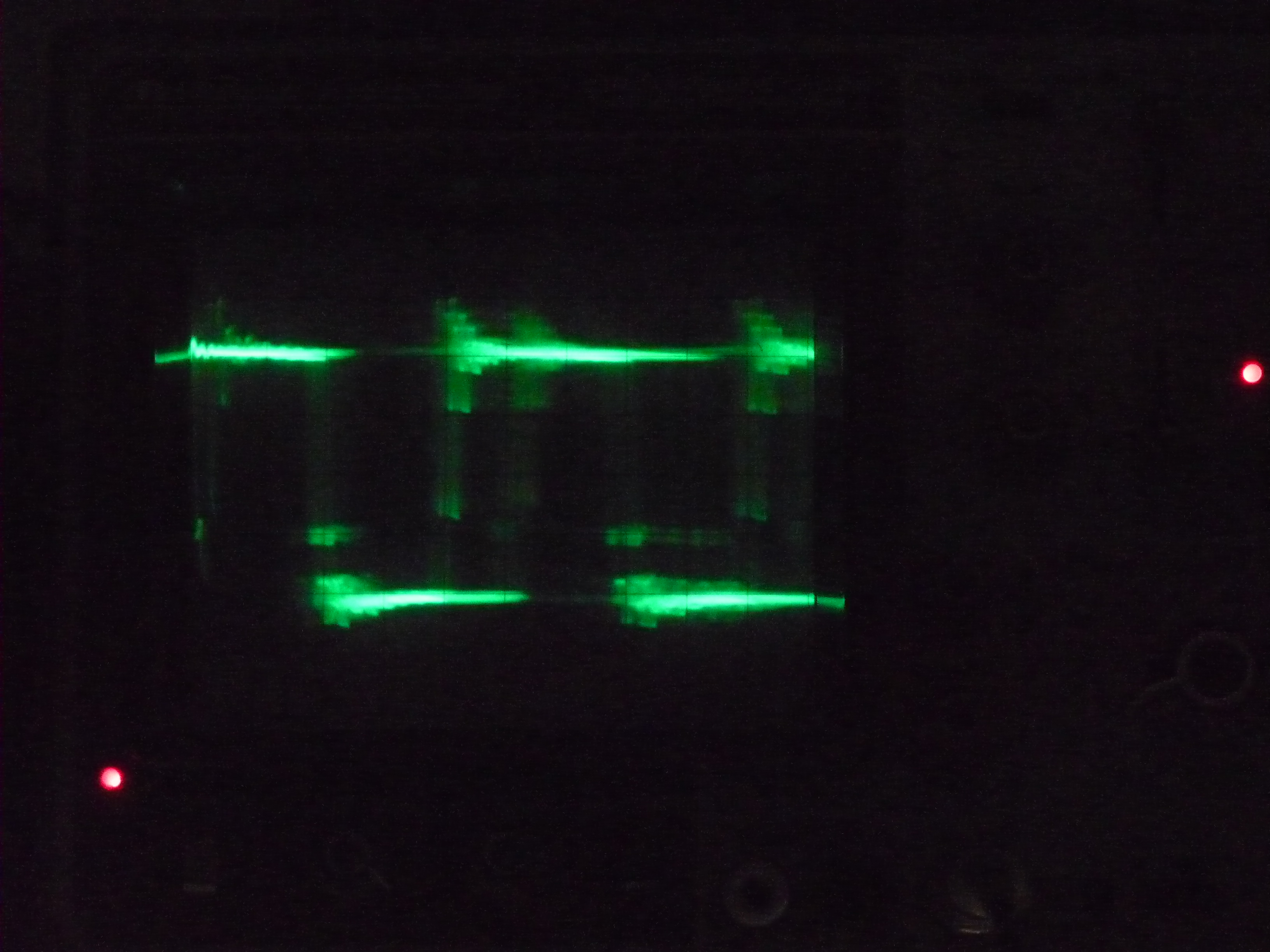

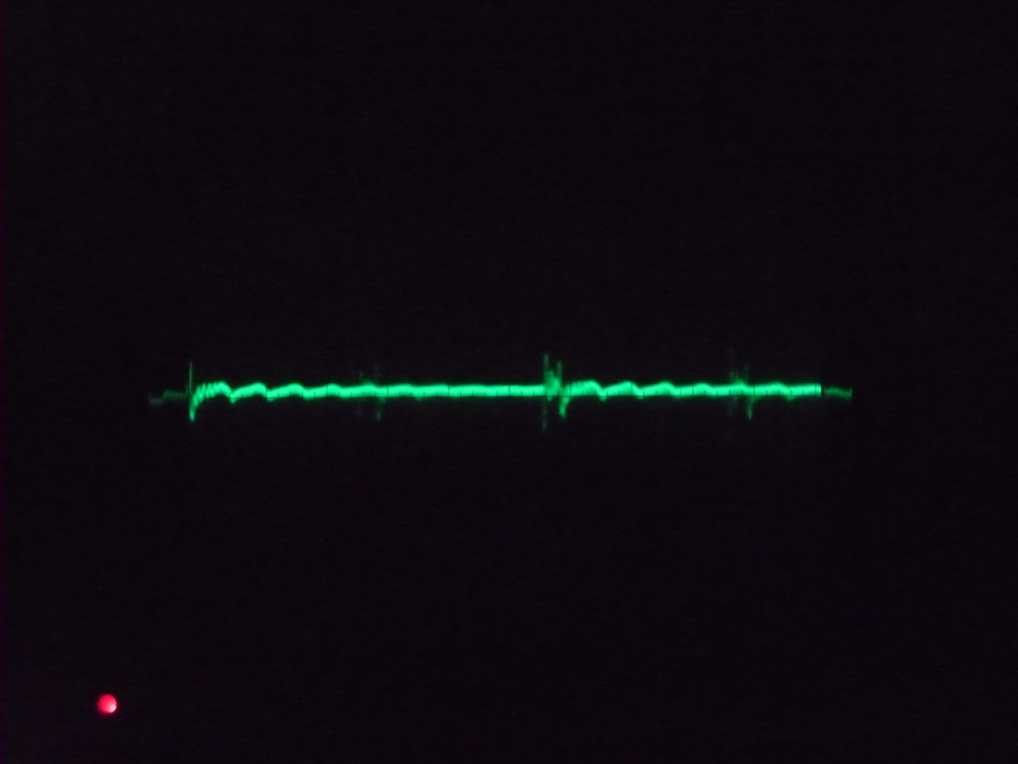

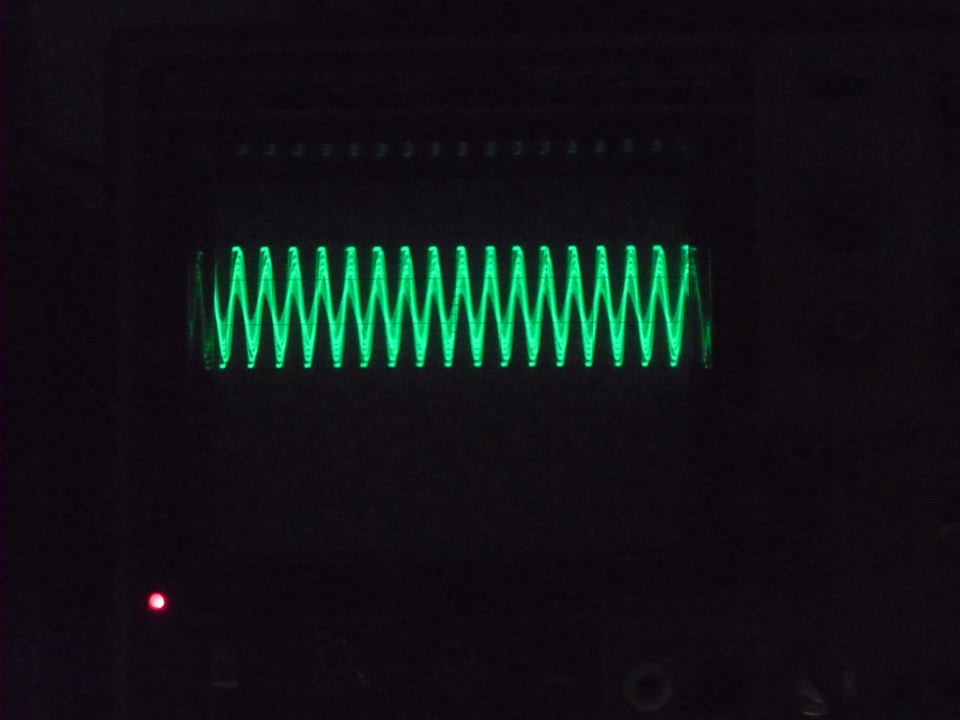

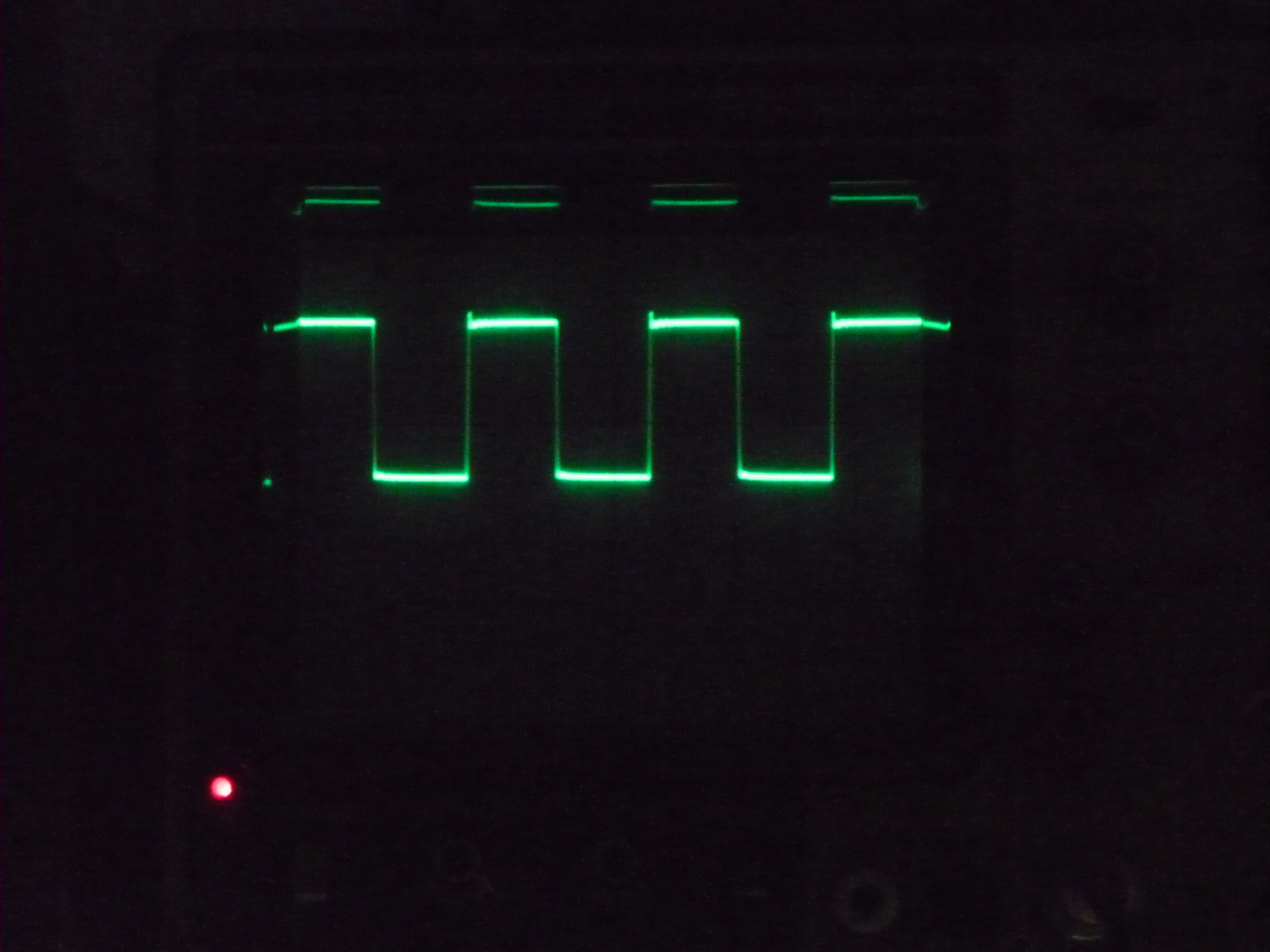

    I haven't tried changing the current sense resistor yet, but I thought I would share the traces I was able to capture. I apologize for the poor quality. I'm working with an ancient 10 MHz analog scope. I don't have a very effective way of capturing traces.

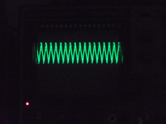

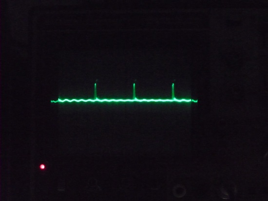

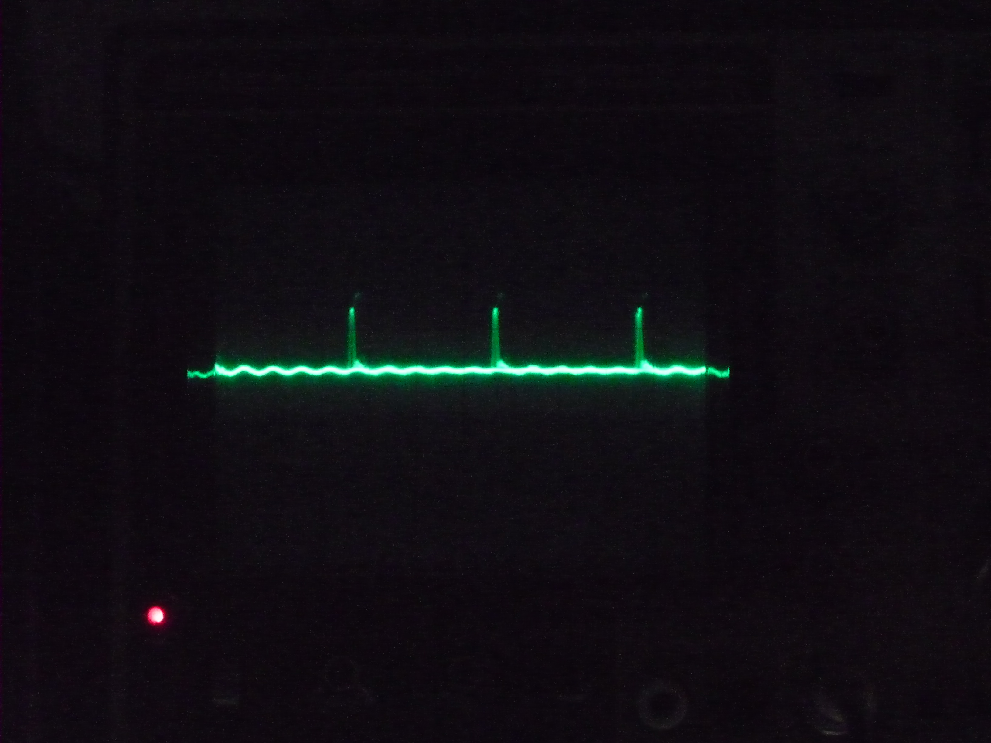

    OUTPUT:
    No load, 100mV and 1 uS divisions with the scope on AC
    I realize you can barely see the divisions. The blips are separated by about 3 uS and the Vpp is about 100 mV to give you a sense of scale
    50 ohm load, 500mV and 1 uS divisions on AC
    I was running the output to an adjustable power resistor. I put the camera on burst and slid the wiper along until it quit switching. This normally occurs around 18 ohms or so.
    Last image before it stopped switching: 1V and 1 uS divisions on AC

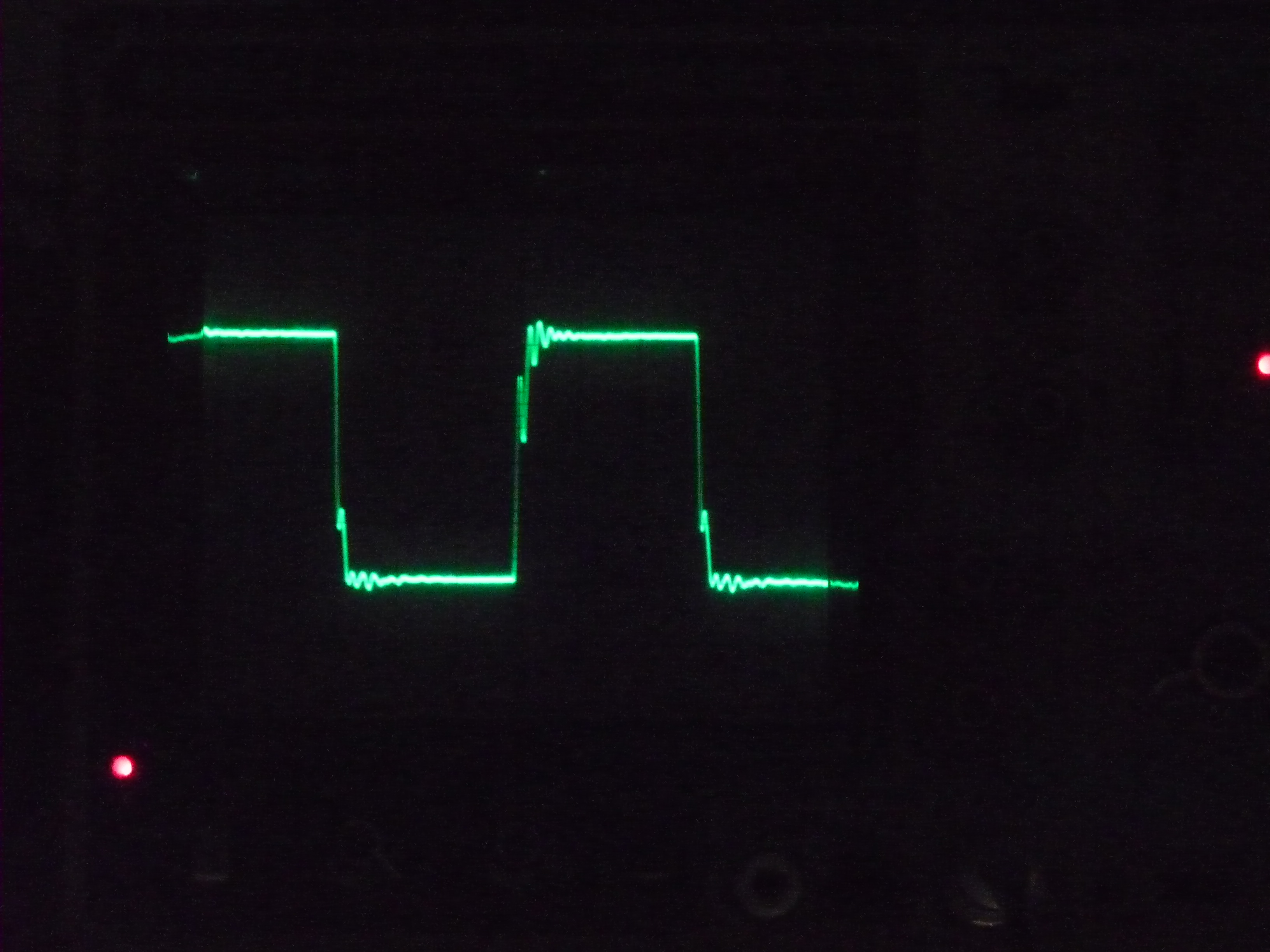

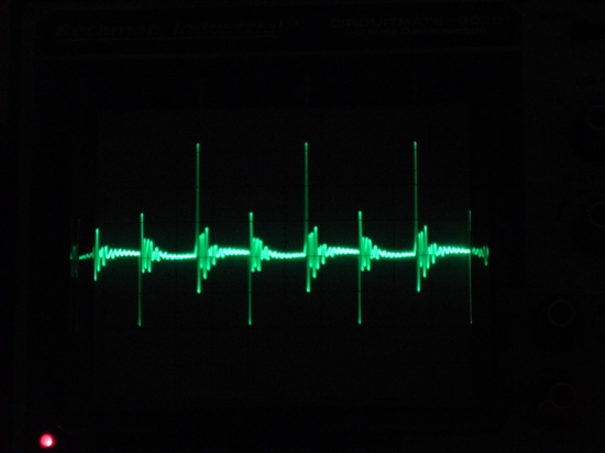

    Switching Node:
    No load, 20V and 1 uS on DC
    50 ohm load, 20V and 1 uS on DC
    Same as before; last image before it quit switching on the same settings as before:

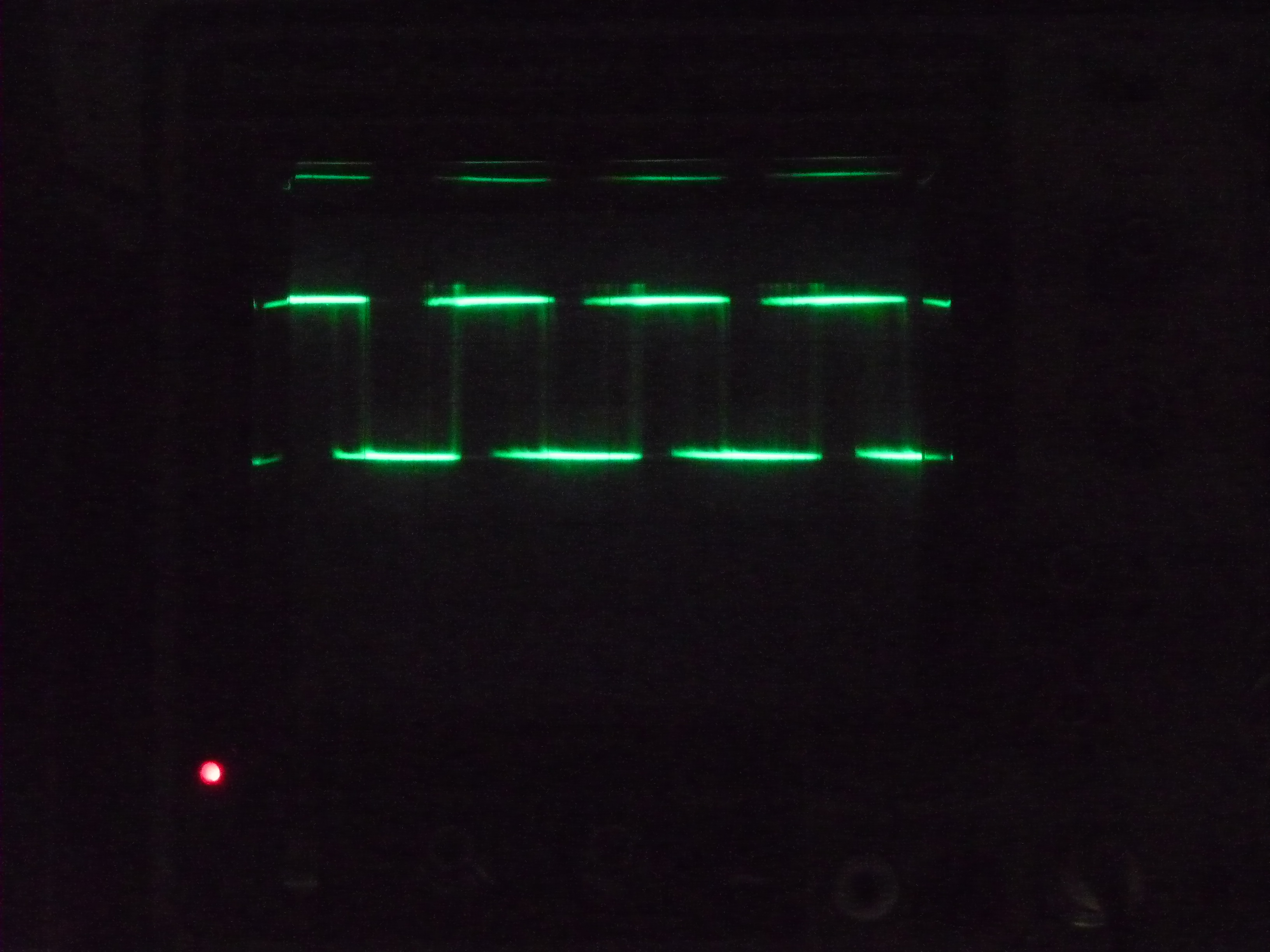

    Gate Drive:
    No load, 5v and 1uS per division on DC
    Now we have gate drive with:
    50 ohm load, 2V and 0.5uS divisions on AC
    And finally, the same settings as above but the last image before it quit switching:
    (Same thing but with different shutter speed)
  • Hi Tom,
    Were you able to test with the lower current sense resistor? When you test this I recommend increasing C6 to 22nF and reducing R3 to 10kΩ. Reducing the current sense resistor decreases the gain of the control loop so the error amplifier closed loop gain should also be decreased.
    After looking over the screenshots, I see a lot of jitter in the ones taken right before over current is triggered. Does the jitter slowly increase or is it only seen at the maximum load the supply is currently capable of?

    Forgot to update this thread. I did try the lower resistance current sense resistor. I soldered an axial lead 0.01 ohm resistor in parallel with the surface mount 0.01 ohm resistor. It did make some difference. By slowly "creeping up" on the target current, I was able to get to about 3.2 amps before shutdown. If I simply turn on a resistive load that would draw ~2.5 amps, it shuts down.
    The jitter occurs when I am "creepin up" on the target current. So, with the lower current sense resistor, a small amount of jitter appears around 2.5 amps and gets progressively worse until shut down at about 3.2 amps. These numbers are approximate; sometimes it remains stable until 2.8 amps or so and I get to about 3.5 amps, etc. I will try changing the error amp loop gain in the next day or so.

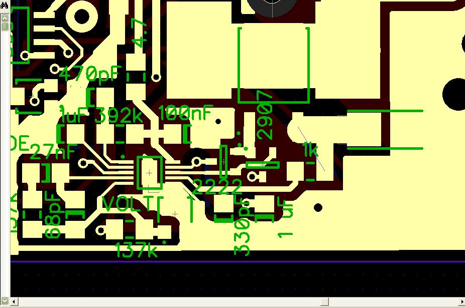

  • Just to be clear, my current board is based around the reference design that was shared in an earlier thread. I am no longer using the design that was originally posted from the SwitcherPro software, although it suffered from the same problem. I have attached the .pdf of the circuit. The MOSFET that was specified in this design was a T0-220 package. With the complimentary BJT transistors driving the gate and with the smaller d-pak design, I find it hard to believe that switching to SON package will improve the situation. (But I will see if I can kludge something together on the test bench - as a small business our PCB manufacturing costs are not negligible, so I would prefer to avoid etching another set of boards until I have something a little more definitive)
    If the lead length really is an issue, I have to believe that the trace length is an issue to, but I don't see how I can get it much more compact with my manufacturing technology. We can go down to 0608 package size for passive components, but we really prefer to stick with 1206 or larger. Similarly, the MSOP package that the TPS40210 comes in is really the limit for what we can handle. The SON packages typically cause us a lot of grief because of our process limitations and the fact that there are no visible leads. On unrelated boards, we've noticed that about 25% of the SON packages end up with solder bridges between the pads, despite the solder mask on the board. We can reduce this number but then we found that we had problems with insufficient solder on larger pads.
    Current Design:
    3716.48V6ASupply_TPS40210.pdf
    Also, here is a screen shot of the board as designed. There are some unrelated components to the left and the inductor, diode and input/output capacitors are not shown. The inductor and diode are directly above the d-pak footprint and all are in close proximity. The "wings" on the d-pak footprint are pads for a board-level heat sink, in case it became necessary. For a sense of scale, the unlabelled IC is obviously the TPS40210 and the passive components are 1206 package. The two BJTs are SOT23 package.
