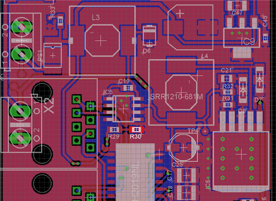

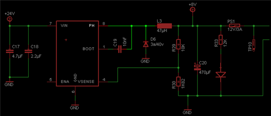

I use TPS5420 in my different projects. I have already use successfully the IC on another PCB.
You can see below my schematic (24V in, 8V ouput)

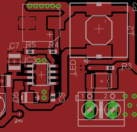

On my last pcb, I have my 8V, and every works fine. But with my new pcb design, I have 4.11V, and Vsense is not 1.221V but 0.5V !
I can share my pcb design for old and new if you want.
