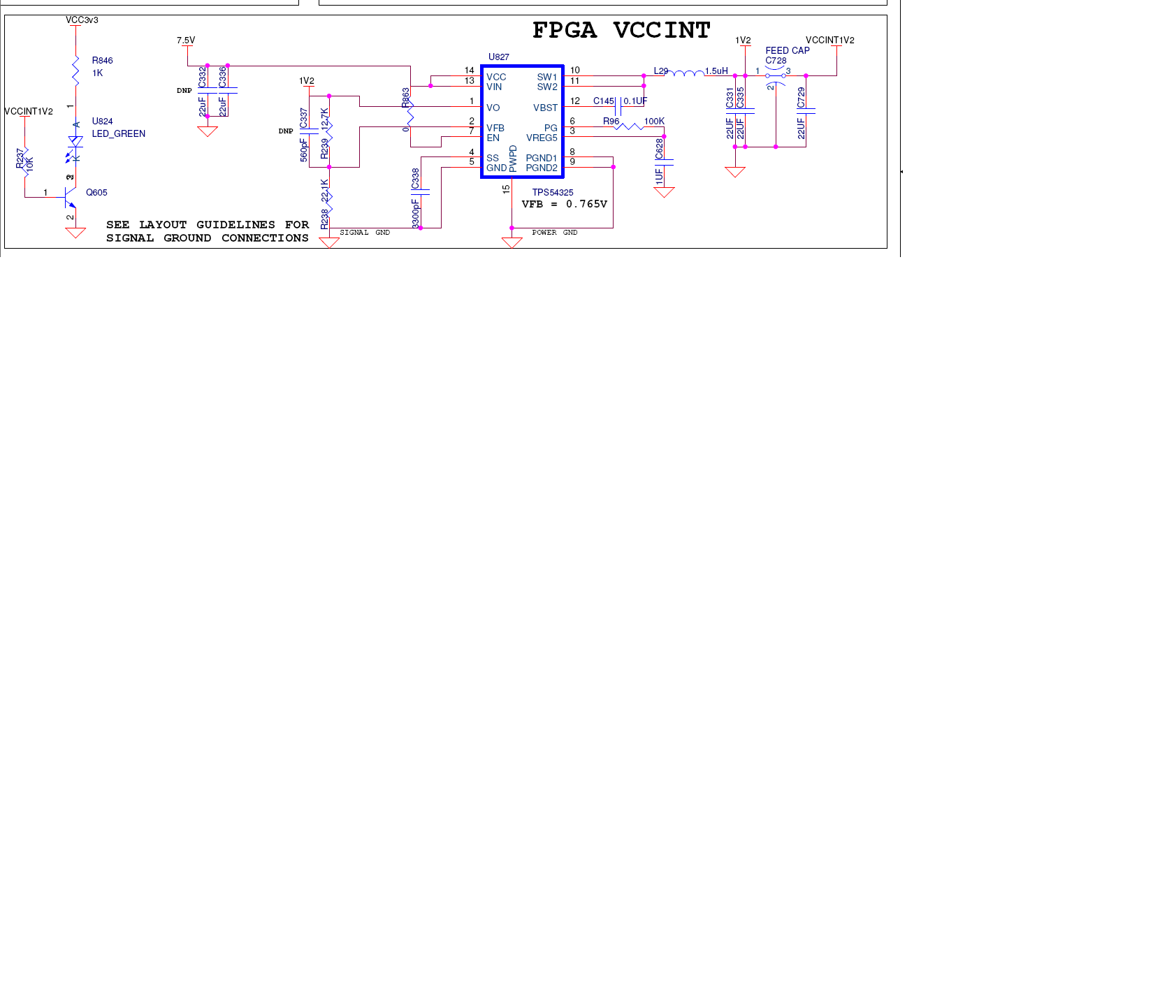

  • hi
    I used this tps54325pwr for generating 1.2v as shown in the attached file.
    Problem is when i fuse my FPGA then it consumes some current and my voltages goes down to 0.99V(avg voltage). and noise is increased. pls suggest what should i do to maintain my voltage again @ 1.2v.
