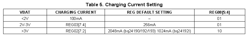

    I am trying to understand if some built-in software protocol with the BQ24190 is being called when you disconnect/reconnect the USB charger. The default charge current settings are shown below, so perhaps there may be some issues in setting the charge current around the ~3V deep discharge threshold, where the default current limit is 256mA.

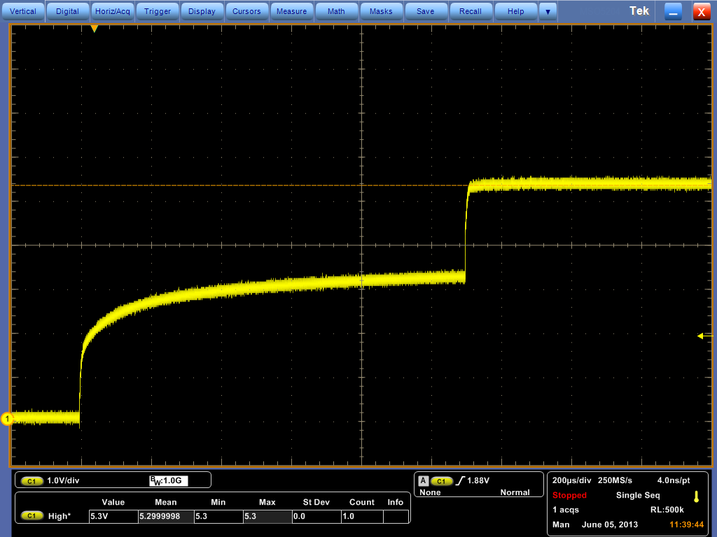

    4. I've used 2 different chargers, one that works and one that creates this low input current issue.  On both, the VIN goes over 5.0V.  However, on the one that doesn't work, it immediately goes to about 1.5V then ramps up to 2.5V over about 1ms, then at 1ms, the voltage immediately rises to over 5V.  On the charger that works properly, the voltage immediately goes to over 5.0V with no intermediate step.  Could this be the heart of the issue?

  • VIN of non-working charger when applied to empty battery...
    VIN of bad charger when re-connected (this is the case where current seems to be correct)...
    VIN of charger that always works properly with empty battery...
